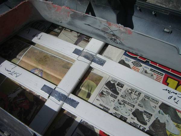

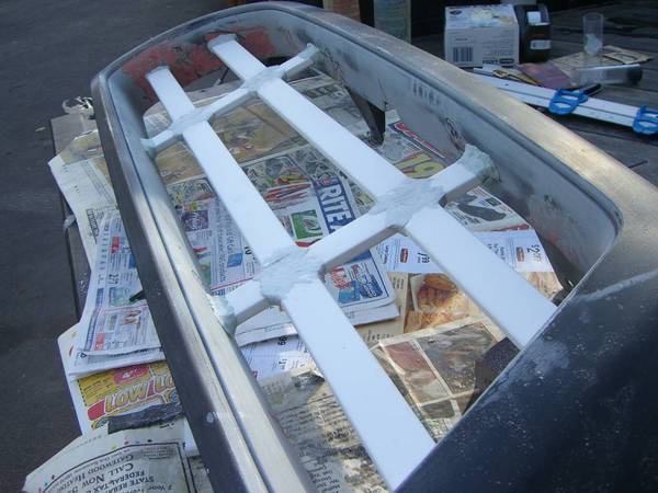

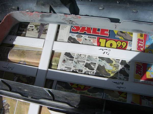

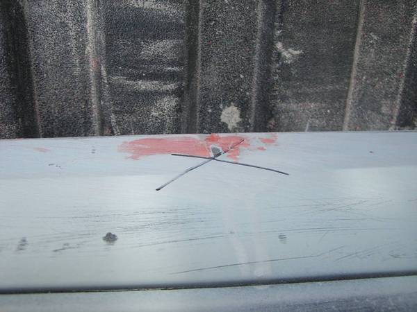

    Just before the part for mounting the screen in the back is where I stopped. First thing I did was marked it where the cross members were to be mounted

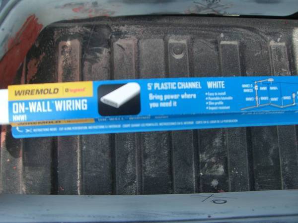

    The biggest problem was finding a material to use for the cross members. I had lots of ideas, but couldn't find one thing easily that would work, until I came across some wire molds in a hardware store. Bingo! The wire molds have worked well because they are light weight, but still durable, easy to cut, and don't require any welding. Here's a picture of the packaging:

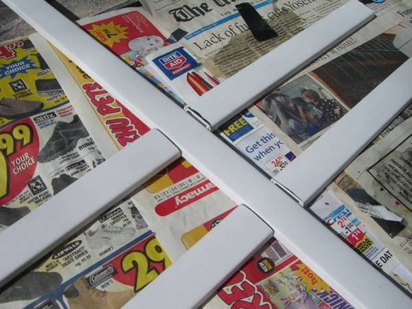

    I bought two lengths, cut each in half and laid them down, and cut them in the appropriate places, then used epoxy to glue them with a piece of tape on top to keep the pieces in place.

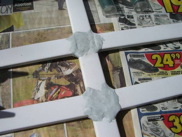

    For extra reinforcement I cut extra flat pieces off the stock center part of the grill and used epoxy to attach them to the four joints where the cross members connect.
    Flipped over

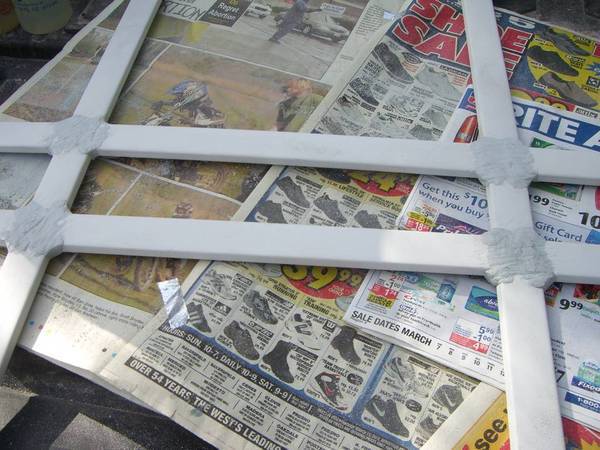

    Next I used adhesive putty on the other side to mold it so it would have "rounded edges."
    Sanded down the putty once it was dry a couple hours later using a dremel and and sand paper.

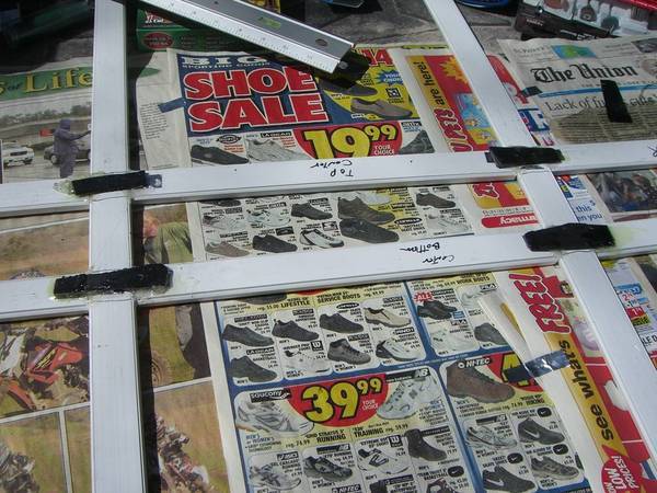

    Cut the ends of the cross members and then used a combination of epoxy and the same adhesive putty to hold it in place and mold it.
    Right now I'm waiting for the putty to dry so I can so a little sanding and then I will use filler primer and paint it black. I have ordered an extra Toyota emblem and will be adding that to the grill once it arrives. :D
