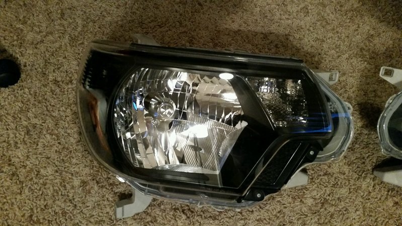

    I agree with toendanger, aftermarket headlights like the spec-D's you mentioned above are always terrible. Low quality, LED's/Halos are always dull and burn out quickly ect.
    I always recommend retrofits, but they are expensive if you're on a tight budget. If you're looking for a cheaper alternative, you could always just do a little bit of painting, get rid of some of the chrome. ( at least for the 12-15 models, im not familiar with how the 2005 headlights are set up). a little bit of paint can make a big difference

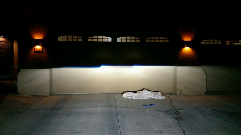

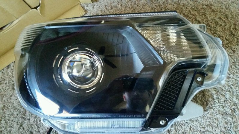

    Retrofiting is installing HID projectors in your halogen headlight housings, and changing your system from a halogen setup over to an HID system. The picture i posted above is a stock halogen headlight, and the picture below is a retrofit i did with HID projectors.
    HID bulbs are a lot brighter than halogen and come in different colors depending on the temperature of the bulb. You are able to have brighter headlights because there is a very defined light cut off that keeps light from blinding other drivers. Whereas the stock halogens just sort of throw light everywhere; Which is why if you see a vehicle behind you with horribly blinding headlights, its because they either shoved an HID bulb in it, or used brighter halogen bulbs, which are annoying and dangerous

    Those are extremely nice. For if this doesnt work like i would like, i will find the videos on retrofitting my old to the new hid setup

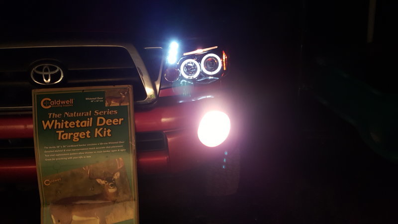

    Here you go installed

    Yeah not bad. How's the output ?

    Nice, head lights, how much, and do the fog up??

    The output is phenominal! Just as good as oem,

    No fogging, 144 from ipexmotoring on ebay. Ships from spec-d tuning

    Cuttersblock are those spyders?

    No they are spec d tuning
