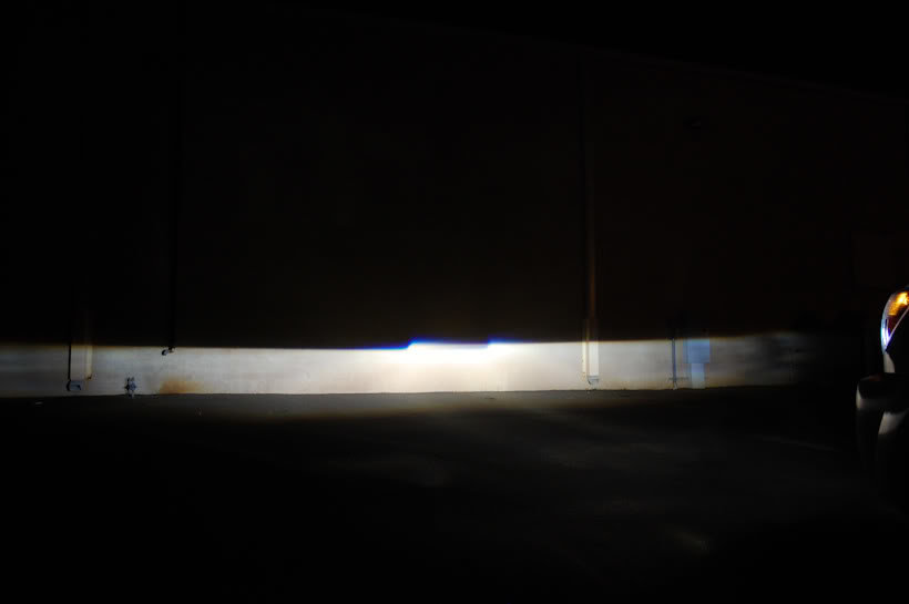

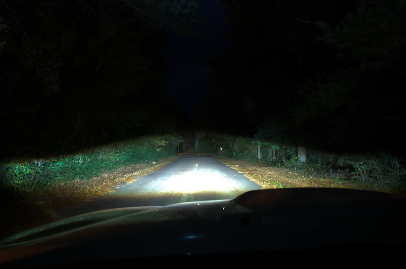

    4x2 Prerunner. Hankook Dynapro ATM rf10 265-65-16, e-locker FTW! Morimoto d2s bi-xenon HID projectors, Philips 85122+ 4300K, Cobra 75 w/ 3' firefly, Kenwood KDC-MP342U w/ SIRIUS, Line-x bed liner, 4' coretrax(black)
    these 4 projectors are all mod free. no cutting of the reflector bowl is needed. im running the mini d2s, although i may upgrade to the mini h1's in the future. still undecided on that one, i like the idea of running oem style bulbs. the quality of the oem bulb WILL always be better than the rebased types
    mini d2s
    mini h1
    g1
    g3
    all photos came from hidplanet.com and were taken by JVX

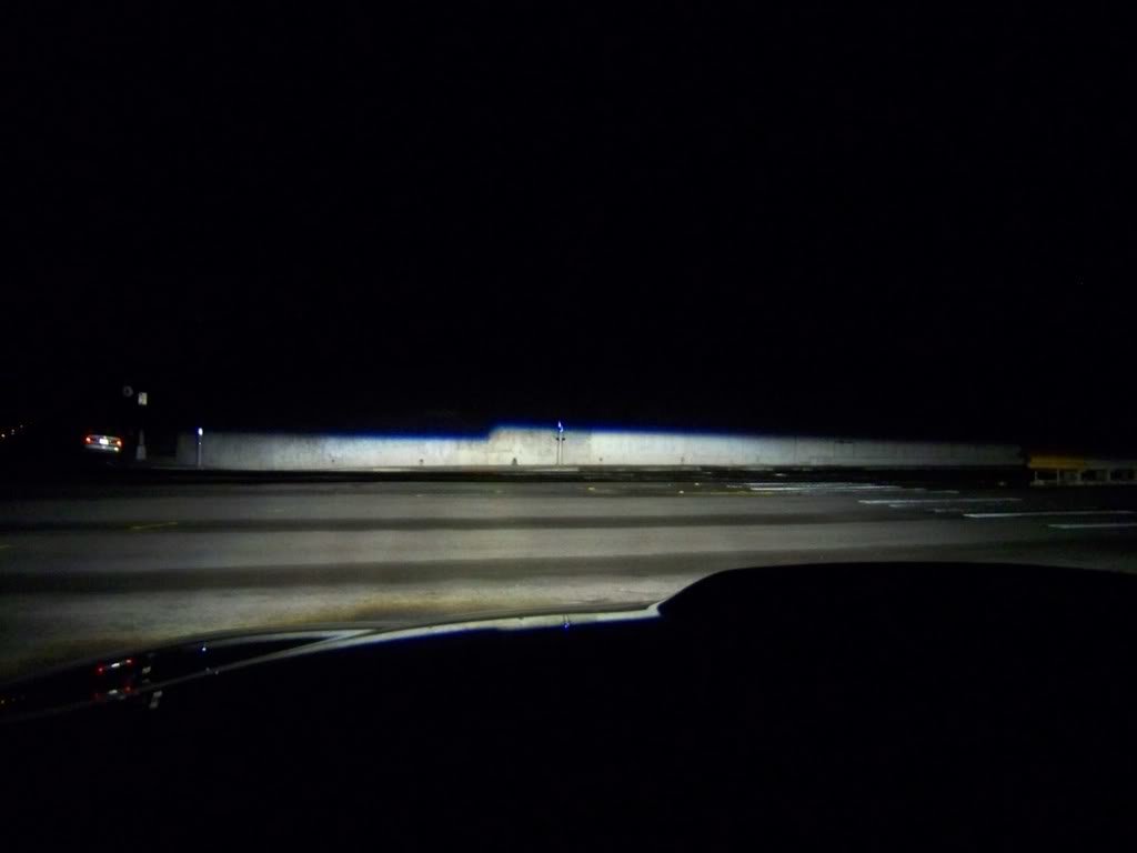

    2005 Tacoma with PnP HID
    2001-4 Tacoma With Cadillac CTS projector retro

    here is my mini d2s retro

    Sweet... That is kind of the shot I needed. High beam?

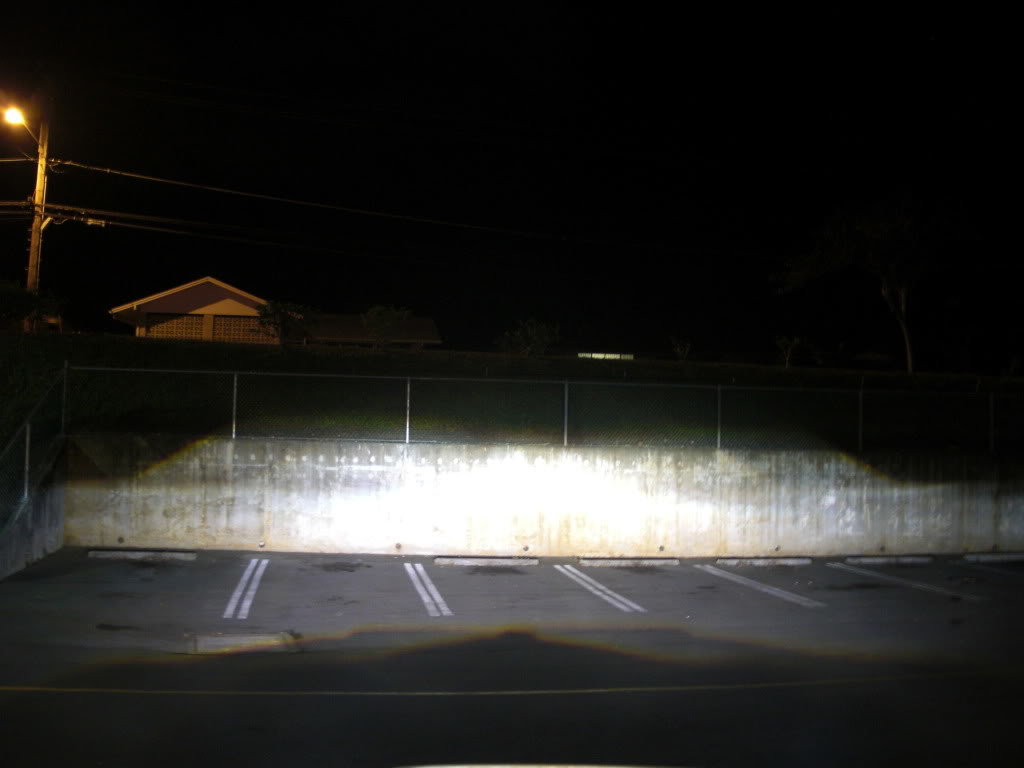

    my tl retro

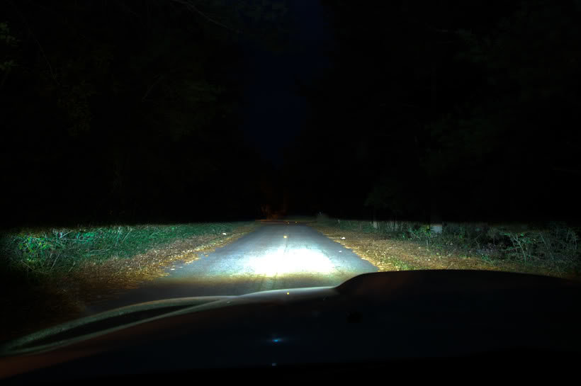

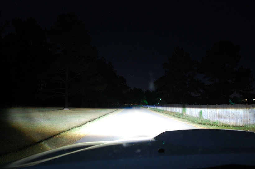

    yes, and it will look exactly the same...just with light above the cutoff! those FX-Rs simply have a sheild that lowers to allow light above the cutoff for the highs.

    low beam
    high beam

    Holy hell! Okay Yosh, now a question... What is the difference between like the FX-R and the D2S or the H1 minis as far as light output goes? I like the seemingly easy installation of the minis... Wondering if I am sacrificing anything?

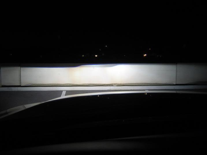

    the fx-r's have a wider beam with a slightly sharper cutoff. cutting is required for installation. mini h1 are completely drop in's
