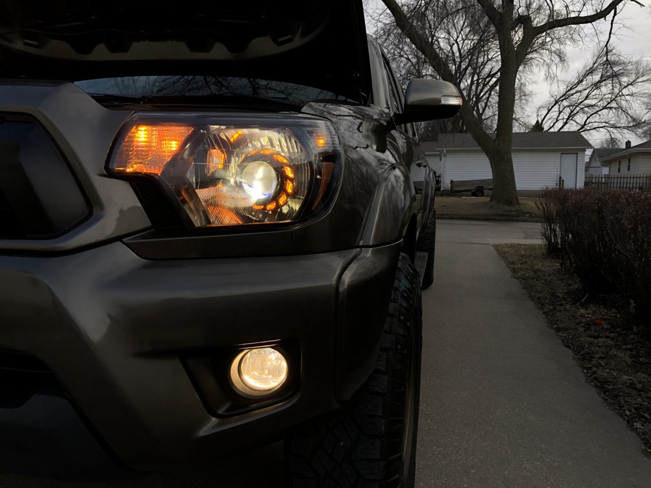

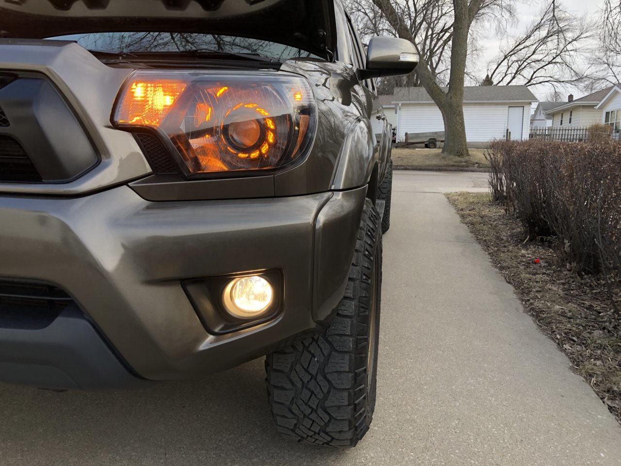

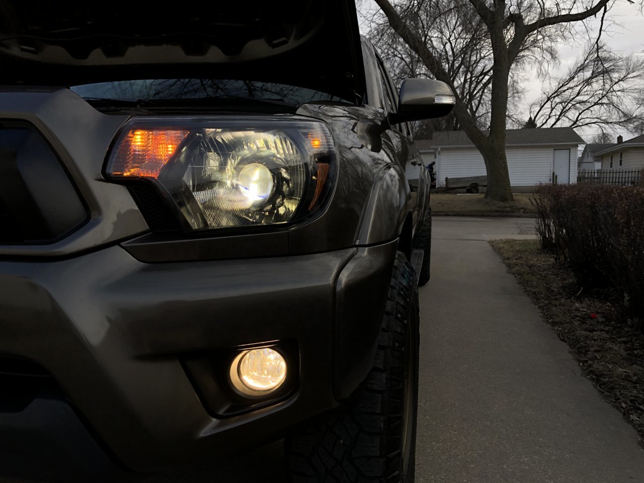

    This is my setup. RX350 EU with clear lens swap, Osram Nightbreaker Unlimited bulbs, Hella Gen III ballasts, Turbine shrouds and Profile halos. The headlight bezel and projector shroud is painted a GM metallic black, if I were to do it again I wouldn't go with a fancy paint like I did, you can't really see the metallic much.
    Currently I have it wired so only the amber on the halo's are on. I feel like the white light is a little overplayed and it blends well with the driving lights.
    DRL on, Halo blinks with blinkers as well.
    Low beam with blinker on.
    Low beam with blinker off.
