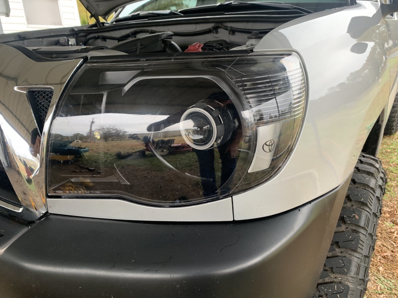

    How hard was it mount the projectors in the bowl?

    From the looks of the MLED 2.0s I have, that should be the easiest part, other than getting the cutoff perfectly level. The mounting shaft just goes through, you use a H4 adapter plate, and the lock ring screws down to hold it in place.
    The problem I'm having is getting the housing apart.
    EDIT: Unless you want to use the rx350 projectors or some other ones. The Morimotos with the mounting shaft are supposed to be easiest.
