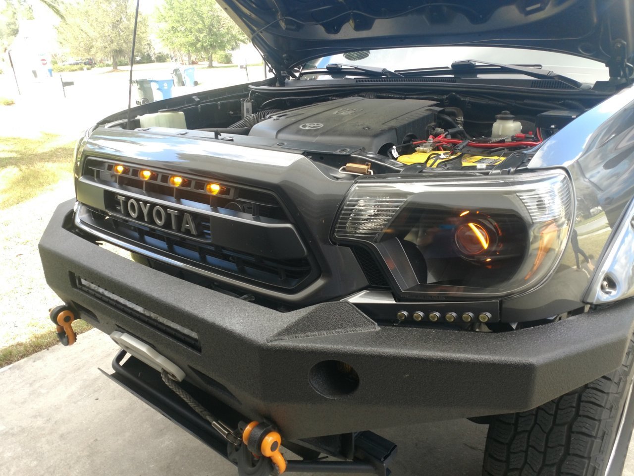

    Retrofit_1_Halo.jpg Got one installed during lunch!

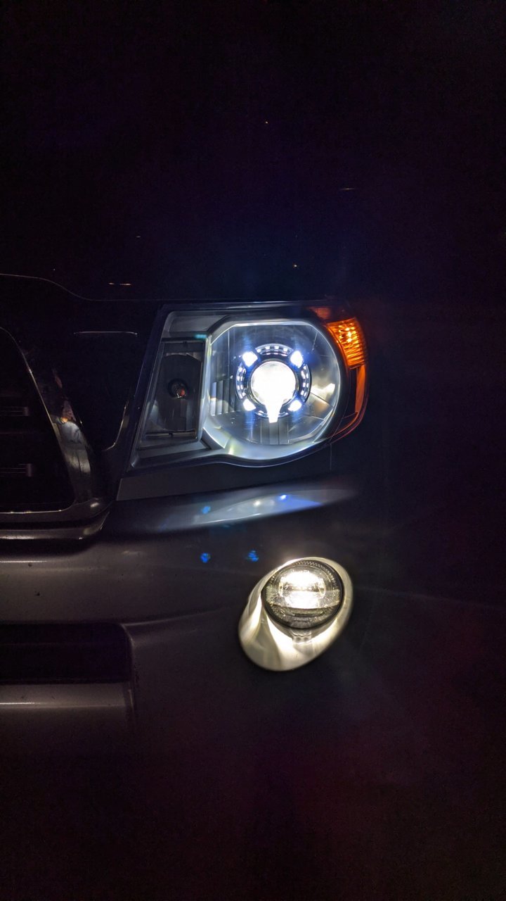

    Well FUCK. Water got in the new retros from a rainstorm 2 days ago, pulled them apart and resealed, and now I'm popping fuse after fuse when I try to switch to high beam. I wonder if I got water in the motor for the high beam. I'm so unbelievably pissed off. I just spent 5 hours to make sure it was perfectly sealed and now I have no high beam. FUUUUUUUUUUUUUU....... Any way anyone knows of to make it work short of popping them apart a THIRD TIME? I'd much appreciate it.

    I doubt it’s the high beam actuator. Here’s a few things to check....
    -Connectors for corrosion/shorting.
    -Check the connector on the H4 MotoController, mine had corrosion buildup after only a couple weeks and shorted to the “ON” position. I cleaned the connector, added dielectric grease and all has been good since.
    -If all that is checking good. Grab a multimeter and test at the connection at each projectors high beam connector (FYI, a d2s 4.0 I have laying around has 22 ohms of resistance, I don’t know if all projectors have the same spec). If you get .000 ohms, that actuator is shorted. If you don’t have a multimeter, grab some extra fuses.... Disconnect both high beam actuator connectors, flash high beams and see if it pops the fuse. If it does, you know it’s not the projectors. If the fuse is still good, the reconnect one projector (go with the one you suspect being bad first) and actuate the high beam. If there is a short in the actuator, wiring or one of your connectors it will pop the fuse.

    Well I pulled all the wiring in the engine bay and put it back together and now the high beam works again. Oh boy am I relieved! Thanks for the advice. Here's a picture of the finished product:IMG_20200401_230350.jpg IMG_20200407_233410.jpg

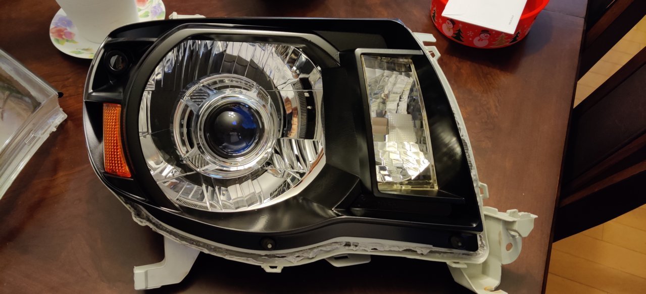

    For what its worth, I had D2/S retrofits and removed them because I found it dangerous.
    Due to how sharp the cutoff was, I could not see ANYTHING above the cutoff at night. So if I was on even a slightly hilly/curvy road, whenever the nose pointed down I could only see a few feet in front of me at best. Basically had to drive with the high beams on to be able to see.
    And before anyone says it, yes they were aimed as high as I dared to go for flat roads.
    Sold the retrofits and went back to halogen bulbs and been happy ever since.
    Here are the old projectors I had though
