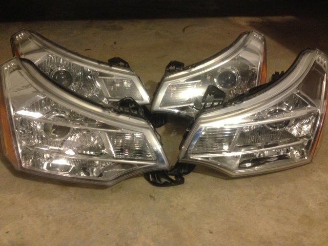

    Eagle eyes I installed on a friends Impala that he got with HIDs for a little over $100. I saw this and I was like wow these might actually be halfway decent...
    Then we backed up to leave the driveway and I started laughing. We were casting a batman call on the hill
