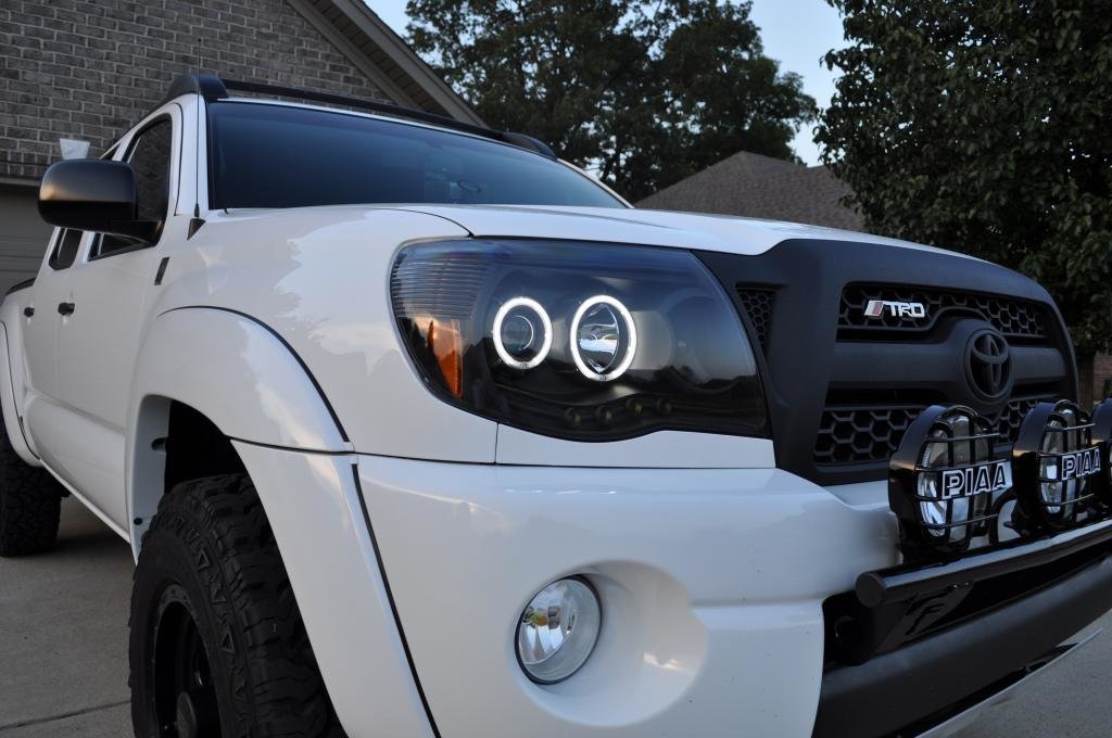

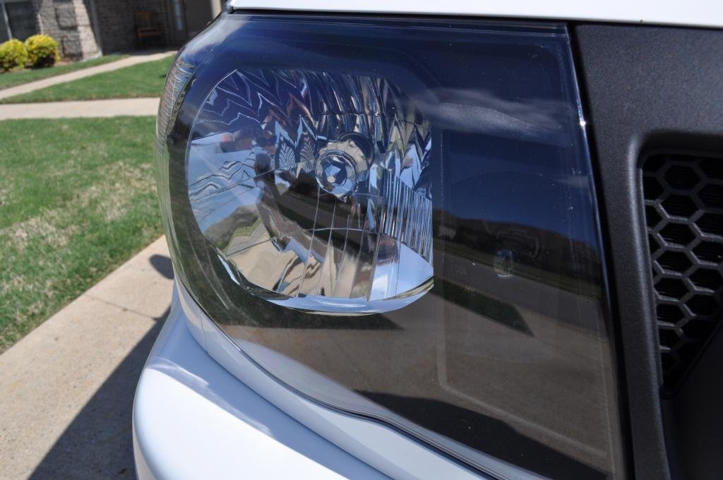

    To the OP... those lights you listed probably aren't bad. By the way they sell them on Amazon too Click Here
    I went from this
    To this (Also bought off Amazon)
    Here is the light output from the new projectors (non HID)
    They are "slightly" less than stock but not bad by any means. No problem with leaking at all. If you do decide to go with those lights make sure that you go with the CCFl Halo's otherwise they will not show up in direct sunlight.

    I had reservations about them at first since they were a spur of the moment buy because I'm worse than my wife when it comes to shopping lol. But the longer they have been on the truck the more I like them. Like I said before... When they do come out for your truck make sure to get the CCFL Halo's so they will show up in the daytime.

    Originally I was going to do a Retofit on a pair of Anzo lights that I bought off of Amazon a while back. The original Anzo lights that I bought off Amazon looked just like the factory lights with the exception of having the blacked out bezel on the inside. When they came in I decided to do the BHLM on my factory lights just for fun and they worked out perfectly. I had the Anzos sitting in my office floor for about 3-4 months and was going to eventually retro them but I was buying some stuff off Amazon one night and these new Anzo projector lights caught my eye. Since I'm worse than a woman when it comes to shopping I thought what the hell... If I like them I'll keep them if not I'll return them. I ended up selling the original Anzo lights that were sitting in my floor.
    Left them on for a few weeks and really started liking them plus they get a LOT of comments (mostly positive). Light output (on mine) is fine but I've heard others say that they suck. You can judge for yourself from the above picture. They are truly a plug and play light with no wire splicing involved.
    Are they as good as actually Retrofitting your factory lights? Hell no! Nothing is. Not even the factory lights. But I didn't have to pull the lens from the housing again and do all the work to the lights. These literally took 10 mins to install then another 10 mins to adjust like I want them.
    I've been really happy with them now that I've had them on the truck for a month or so. No leaks no problems.
