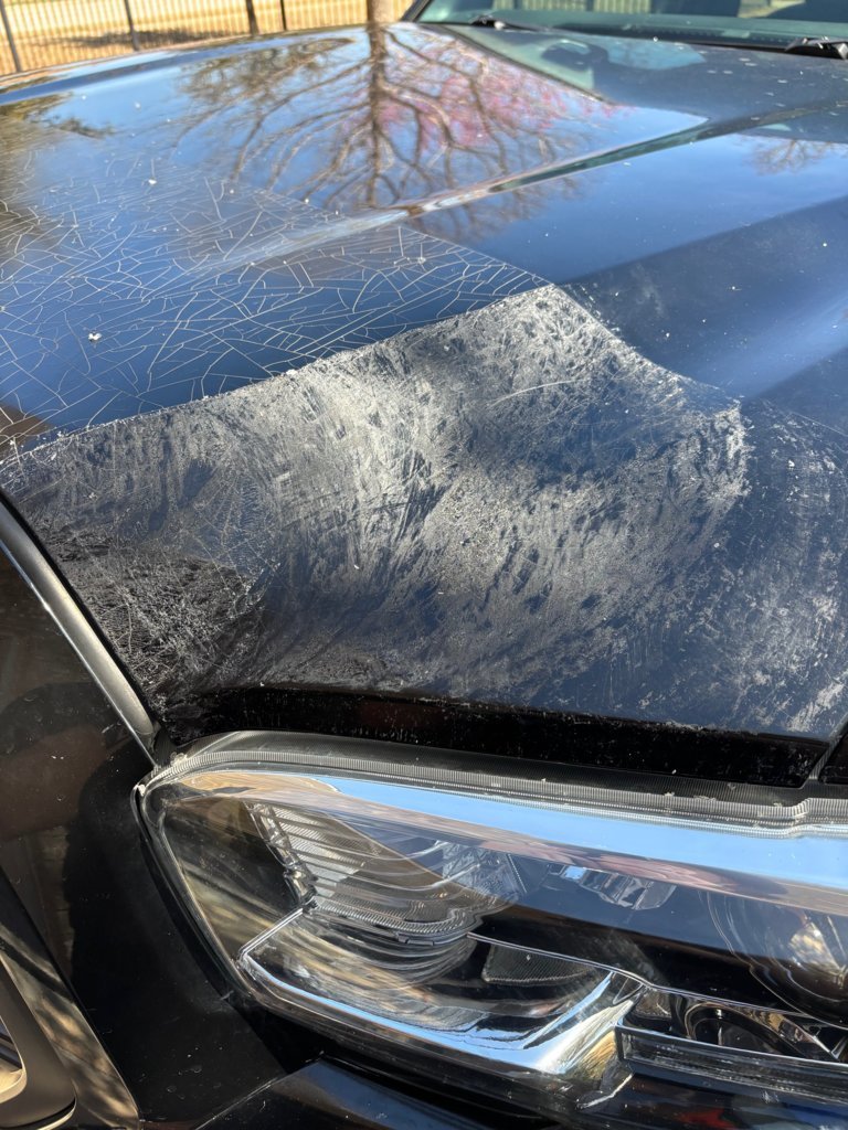

    File this one under projects I wish I had never started.
    Had a nice warm day here yesterday in north Texas so I thought I'd get started removing the old cracked PPF film from the hood of the Tacoma.
    Managed to get all the film off but still a ton of adhesive left behind. Decided to take it to my local body shop and let them deal with the rest of the removal. After they get the gunk off are going to polish the paint for me and it should look a ton better than the cracked film that was on there.

    :duh: Wow, hope it works out. I guess it looks worse than it really is?

    Yeah, it's just a bunch of leftover adhesive that I don't have the time or patience to work on. I'll post up an after photo when I get it back in a day or two.

    That looks like some early generation 3M protection film. Had a similar failure on a new 370Z ten years ago.

    I have a 1944 Gibson SJ that has finish checking like that...

    I thought the cracking was in the paint. :eek:
    I don't know what they plan on using for adhesive removal. Maybe a 3m product, goo off or isopropyl alcohol?
    Sonax Perfect Finish with a yellow foam Rupes pad and a random orbital polisher will clean up a lot of swirls and scratches.

    Isn’t there a special pad for just adhesive removal

    I'm not aware of any random orbital polisher pads for adhesive removal. Pads and polishes for paint correcting heat up the clear coat surface and if the glue residue isn't removed beforehand you're just blending/melting all that into the clear coat and making a huge mess.
    3M makes an eraser wheel, but that's more for bed decals and such. It's not meant for this type of application.
    You need a chemical like Koch Chemie Eulex, 3m adhesive remover or a heat source with a plastic scraper.

    Try Goo Gone, then wash and wax. I used this when I de-badged my truck.

    The adhesive was way too sticky for Goo Gone. Truck is with my body shop guy getting the film removed then he’s going to repaint the hood. Found some scratches after removing the film and a couple of rust spots on the edge from rock chips that hit where there was no film so just biting the bullet and getting it repainted. Should have the truck back tomorrow!

    When I did this, Goo off worked perfect, I tried goo gone first with no results. But goo off took the adhesive right off with no issues

    I tried Goof off as well with mixed results. In the end I wasn’t going to be happy with the time spent or the results so I took the easy way out and paid someone else!
