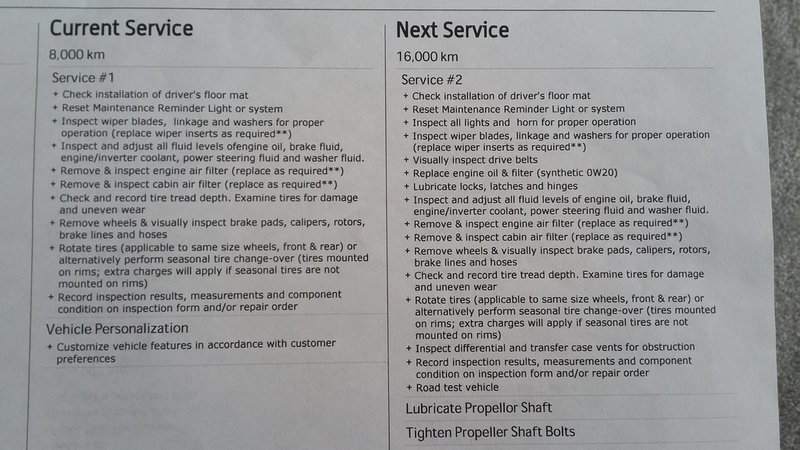

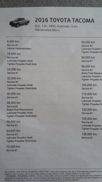

    My service maintenance menu states I have to:
    "lubricate Propellor shaft"
    "Tighten propellor shaft bolts"
    Every 16,000 km
    Stealership will propably charge me to much so I will use them for my free oil changes and do the rest of the maintenance myself. Except I dont know what the propellor shaft is. If you guys shed some light on this subject for me it would be greatly appreciated. I didnt find anything through a quick TW search
    ALSO,
    I found it weird that theres nothing on the schedule about checking the tranny fluid, and since its a pita to check ourselves and there being constant complaints about low fluid, why is there no transmission fluid checks.
