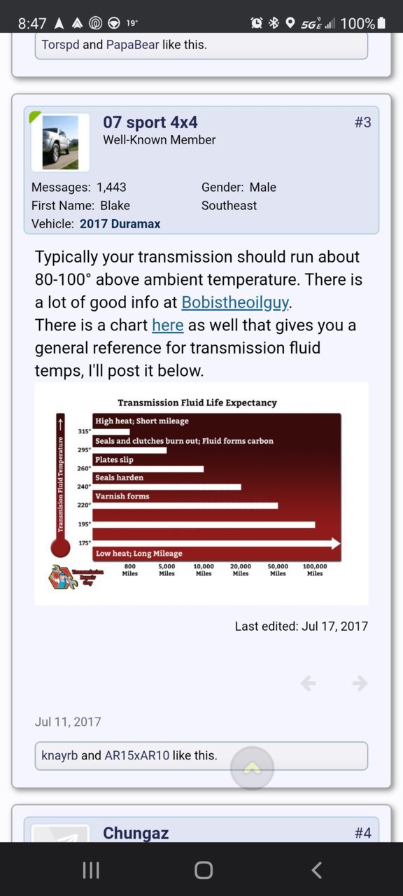

    Looks like someone posted here in an old thread what I was going to try and type out. Pic below
    Having been a automotive tech my entire adult life, much of that at a shop that specialized in transmissions (I did the engine, diagnostics and such mostly, why I was brought in) I can tell you 3 things are the fastest killers of an automatic outside of dumbass abuse.
    HEAT is the first above all. Followed by leak causing it to run low, finally not changing your fluid.
    For instance, I own a 2003 CRV, 255k untouched engine and transmission. I have beat the hell out of it including 2 years ago towing 1500lbs or so 300 miles from northenr Illinois to st louis, 3 loads. Offroad at what it can handle (nothing like a taco can do), pushing through deep snow, pulling people out of stuck snow banks and so on. Trans still perfect. Still drive it anywhere without concern.
    Except for regularly changing the fluid I did one thing I was bummed Toyota did away with on these, A TRANSMISSIOM COOLER.
    Towing 1500+ in early June doing 65+mph the hottest my trans got was 225 when I was pushing it.
    Look at that graph above, you basically want to keep trans BELOW varnish Temps or change fluid more often to compensate and keep the crap from building up.

    1500lbs up there you should be good, just watch the trans temp on any good climbs. If your not going over 230ish then don't worry about it.
