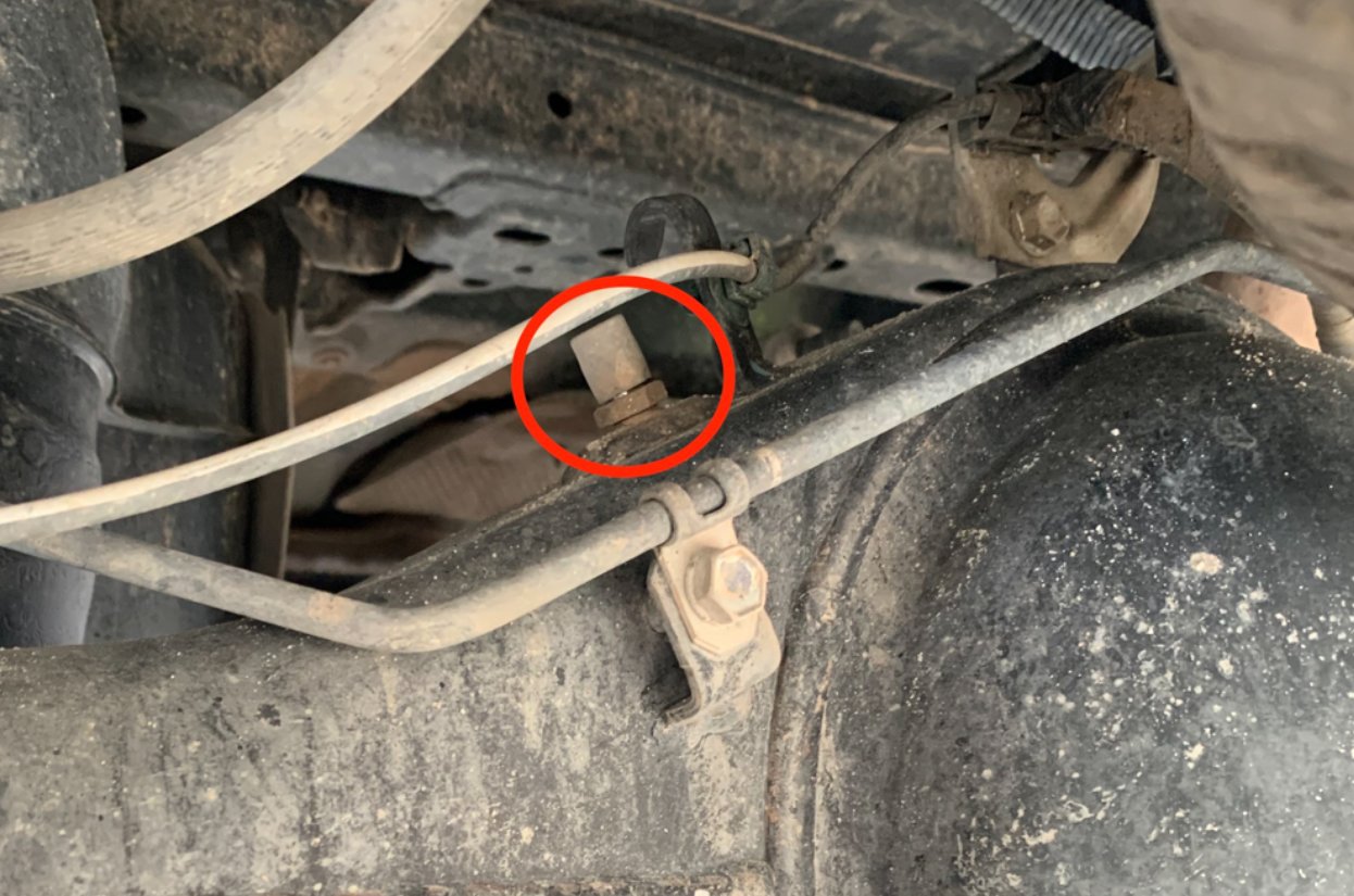

    Ok…I wasn’t paying attention I thought you were just letting me know where to drain my old gear oil from! But…luckily something made me reread your comment!!! I understand now…so if I should be so lucky and it’s this breather thingy where do I go to get one asap and is there a specific part number for it? I imagine there would be. Thank you

    Normally, I like to stick with OEM parts from the dealership.
    But the breather (vent) isn't something that "has" to come from the dealership.
    My local AutoZone has them.
    https://www.autozone.com/suspension...le-vent/p/dorman-axle-vent-924-262/695963_0_0
    OEM Toyota Part - 90930-A3001
