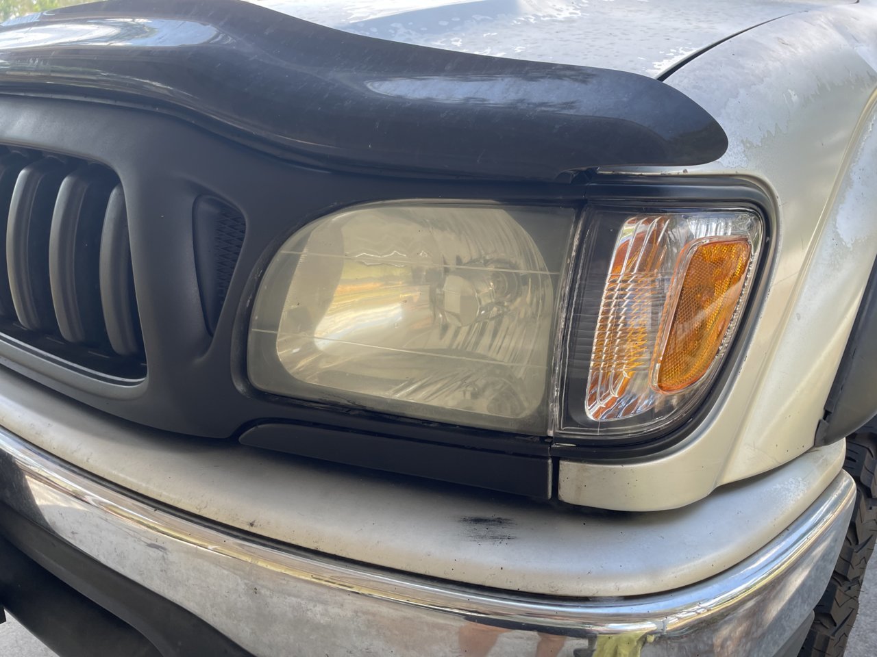

    Thanks for the info. My only question now is about my housings. Been reading that the housing makes a huge affect on the light output. Ive tried cleaning and polishing them but cant get them perfect. Should get new ones before doing this mod? Heres a pic of them...
    Also, any way of knowing if my current ones are oem? Bought the truck from a person who had changed a lot of stuff out. Thanks.

    Those are not OEM. The OEM units do not have black behind the lens. Changing out to OEM will be an improvement over aftermarket, but doesn’t have to be done at the same time.
    Edit: ^This statement is inaccurate. See my following post.

    Damn those look terrible. I’d get a new set, you can probably find some oem at a car-part.com. They lenses shouldn’t yellow like that, getting hazy is typical with age but easy to fix.

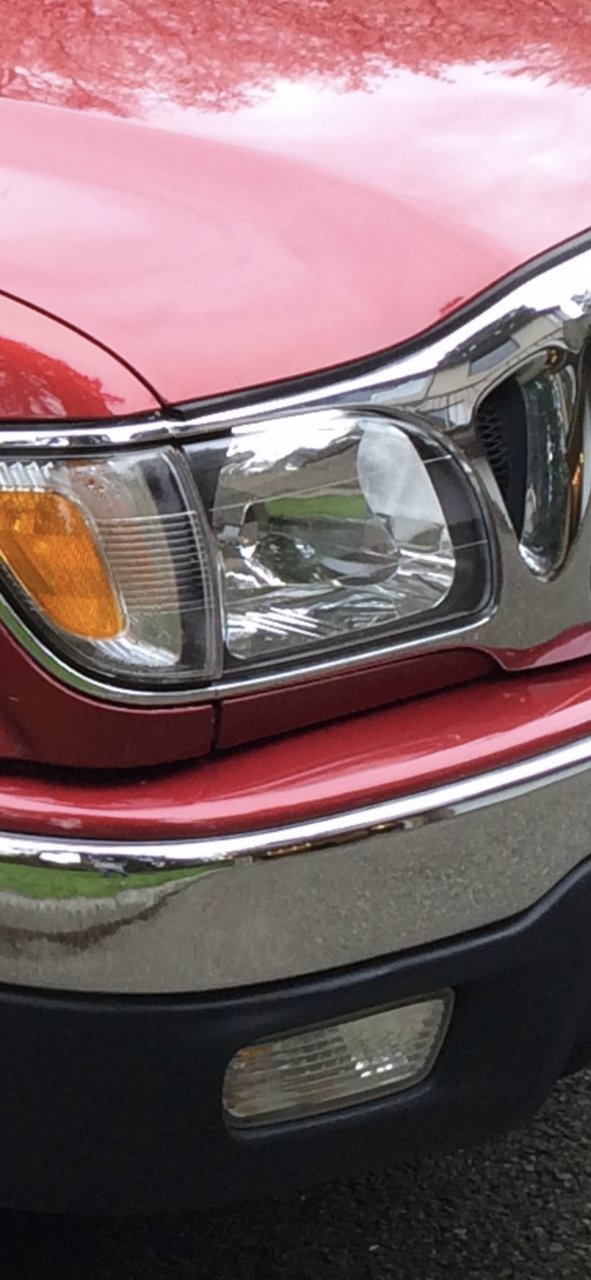

    20210508_160639.jpg Definitely not tryin' to start a debate, just my 2 cents - maybe his aren't OEM but they sure look a lot like mine which are OEM with black around the edges behind the lens.

    Went back and looked at the new OEM headlights I put on my 03, and you are correct. It was quite a while ago, but my memory served me incorrectly in this case. The OEM lights do have the internal black surrounds.

    Yeah, I have some aftermarket ones that I tried very briefly that have a wider section of black around them. They absolutely sucked for throwing light. Maybe a set something like those is what was stuck in your memory.

    Have you tried cleaning them with bug spray? Any bug spray that has deet should cleanup any of that yellow haze on the headlight. It's not as long lasting as say that 3M sanding kit but if it helps at all then yours are probably salvageable.
