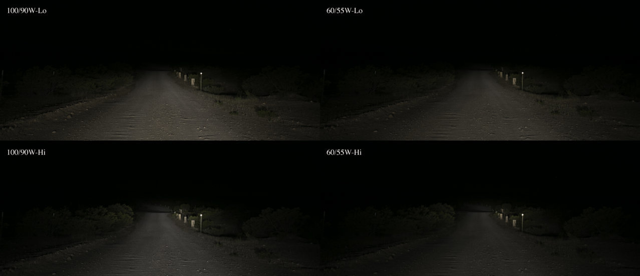

    So I am on the fence on the bulb/wiring harness upgrade or doing a projector retrofit. Last night I did a test out in the desert with Osram's OEM bulbs and the 100/90W bulbs. I'm still using stock wiring and the lenses are pretty clear, I'd say at least 90% of looking new. Here are the results. The 90W bulbs are a little brighter but I'm not blown away. There was a full moon out so I don't know how much that would affect things. I'm sure the harness upgrade will make the lights brighter but I assume it would be proportionally.

    I hardlly see a difference in those pictures, you should have a much more noticeable difference between the 100W bulbs and stock bulbs.

    The 100/90w bulbs will not be much better than stock without the wiring harness. Stock wiring will not provide sufficient voltage for them to preterm, so without the harness the bulbs are worthless. And you risk melting your connectors with the high beam. Several have tried bulbs alone first. It doesn’t work, then we’re significantly impressed once they added the harness so that the bulbs could get the power they need to perform.

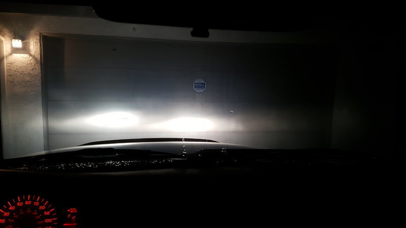

    FWIW, I did the upgraded harness and new CAPA certified housings in my 2004. Even with the "stockish" Sylvania bulbs, I noticed a decent difference in brightness, but combined with the new housings, the difference was night and day. Fogged lenses not only make the light not as bright, but smear your light output.
    Before: (lowbeams, orig housings, sylvania bulbs) Notice how my gutters are illuminated!
    After: (low beams, new CAPA housings, same sylvania bulbs as before and "ultimate" wire harness)
    Wulf, taco03Trd and goldentaco03[OP] like this.

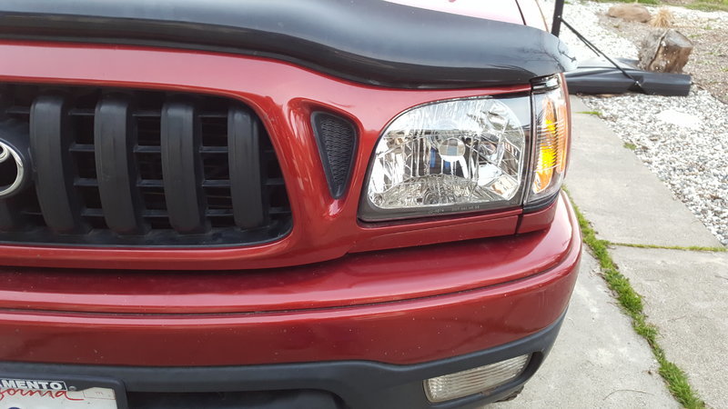

    How is the fitment on those CAPA lights? Years ago I bought some non-CAPA off Amazon and the fitment and throw were horrible and sent them back. The gap between the headlight and sidelight was pretty far off and stuck out a little. Rock Auto has CAPA lights for about $30. Time to use that 5% coupon and get some poly LCA bushings as well. My cheap light bar setup. Looks discrete and have a factory lighted switch installed in the lower console rectanglur cut-out. Would like to get all the chrome up front color matched and maybe do the front blinker mod.

    CAPA is the same qa/qc process OEM goes through. They were as far as I could tell identical. The light cutoff in teh pics I posted obviously aren't quite as good as modern projectors, but not bad for 20 year old technology, especially considering the cost.
    It was the TYC brand from Rock Auto. I think mine were like $40-45 but still easily worth it - half the cost of OEM.

    Exposure must be lower in the second picture (look at the speedo brightness), exaggerating the effect of the cutoff. If you post exif data, we can adjust exposure in post processing, better approximating a true comparison.

    Those are cell phone pics, the exposure is whatever it chose to be. I'm not doing peer reviewed research here.
    You're free to photoshop those pics all you want to get whatever exposure level will satisfy you, but it's a pretty clear and simple comparison.
