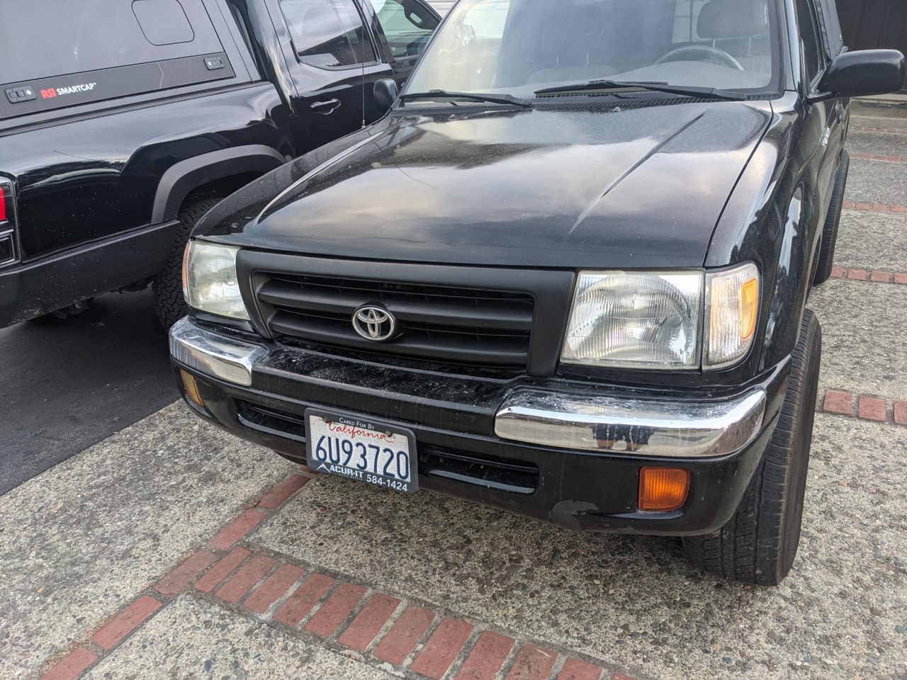

    Spent about 1hr and $15 of material on headlight restoration. I plan on coating with a 3M clear coat to stave off the yellowing process for a bit longer.. My question now is should I dump $50-100 on a LED retro bulb like a Hikari or... The complete housing projector retrofits just came back in stock for $220? I kind of like the keeping the look gen appropriate, the cleaning made the output probably 100% better but I've grown pretty accustomed to the clean crisp lines of projectors from my 3rd gen and previous vehicles.

    Nice job on the restore. But did you read the thread? Definitely no on the Hikari LEDs in a reflector assembly, you'll end up with garbage performance and lots of glare to oncoming drivers. If you want exceptional performance, follow the original post in the thread and upgrade to an HD wiring harness and high power Osram bulbs. If looking for a plug and play option without the harness, the Philips Racing Vision +200 have been tested to be the best low beam performers, but won't match the performance of the high power Osrams.

    These two are contradicting each other. Any retro-LED bulb will throw out more garbage light than what you had before lens restoration.
    The only way to get "clean crisp lines" is to get HID projector retrofit. It looks out of line in 1st gen Tacoma IMHO, but if you are for the functionality over the looks, that's the best solution. Any good brand name H4 halogen bulb (not China no-names sold for 2 bucks a piece) will give quality cut-off in stock reflectors. Higher wattage bulbs will give more light while still providing decent cut-off. So what @crashnburn80 suggests is the best balance between look and functionality.

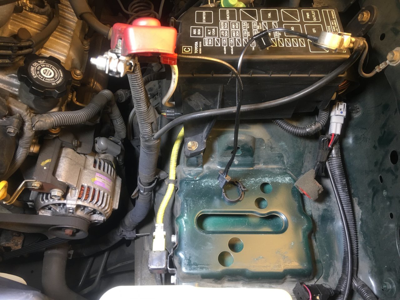

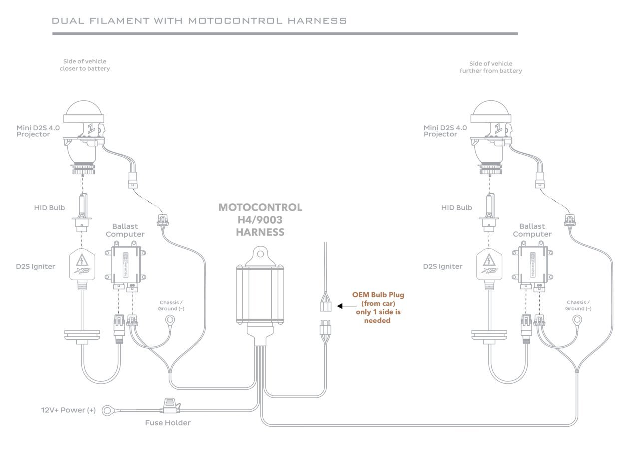

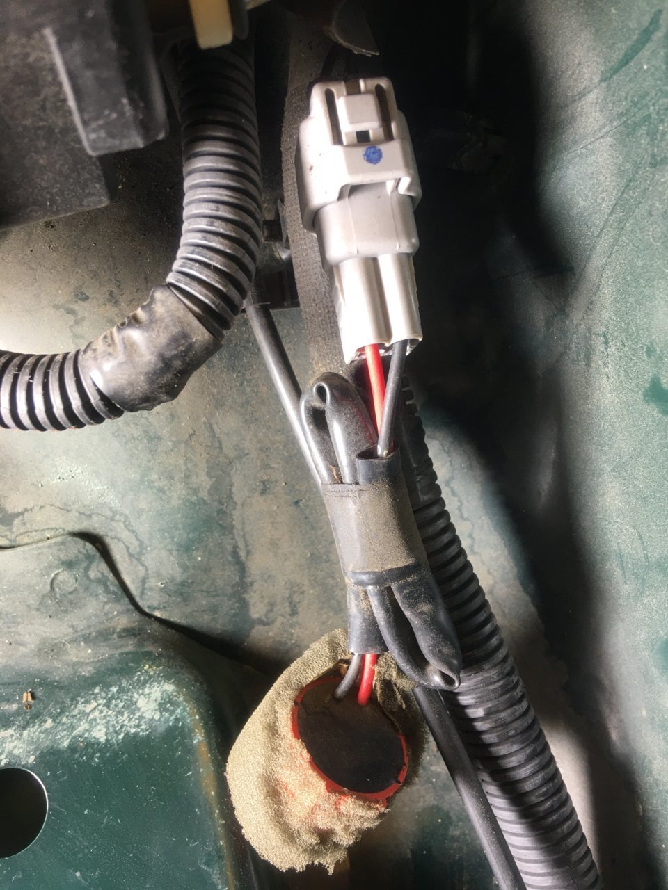

    But having trouble finding where to plug in the new harness (which Im still waiting for). There is also a "relay harness capacitor link" (see photo) which they said was also necessary and the diagram shows it goes between the wiring from truck to the new Morimoto harness. Looked around the relay box and cant see exactly where its (the relay capacitor) is supposed to plug into on the one end of it. Also what is the red thing with decaying foam around it? Is that a capacitor also? Will this get removed and replaced by the new capacitor and harness? Any help appreciated - thanks!

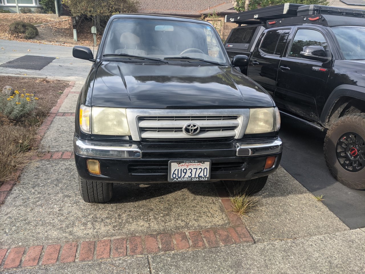

    Not only because of the reasons in this and the above thread, but because that restoration isn't doing you any favors either. While those restoration kits make the lenses LOOK new, it doesn't improve their light beam pattern to anything that resembles a new housing. The damage from UV light goes al the way through the plastic lenses, and no amount of polishing actually fixes that.
    This pic is after I spent hours polishing my old lenses. I even went back after a couple of months and did a second round, and this was the result:
    These are the low beams (conventional halogen bulbs), and note how you can see my gutters illuminated, which means there is a massive amount of glare.
    Compare that to new housings with the same bulbs as above, but now you can barely even see the security sign on my garage door.
    So, long story short, LEDs in halogen housings smear and scatter the light causing glare, and the UV damaged lenses also cause glare even with halogen bulbs.

    ok, so it turns out that the capacitor link cable isnt needed after all. Someone at Retrofit was mistaken. They apologized. And as for the location where the harness plugs into the car, it only has to plug into one of the H4 plugs rather than both. Odd, none of their copious diagrams or instructions mention this at all. Here is the diagram, only I fixed it so now it makes sense.Screen Shot 2021-11-12 at 2.52.35 PM.jpg
