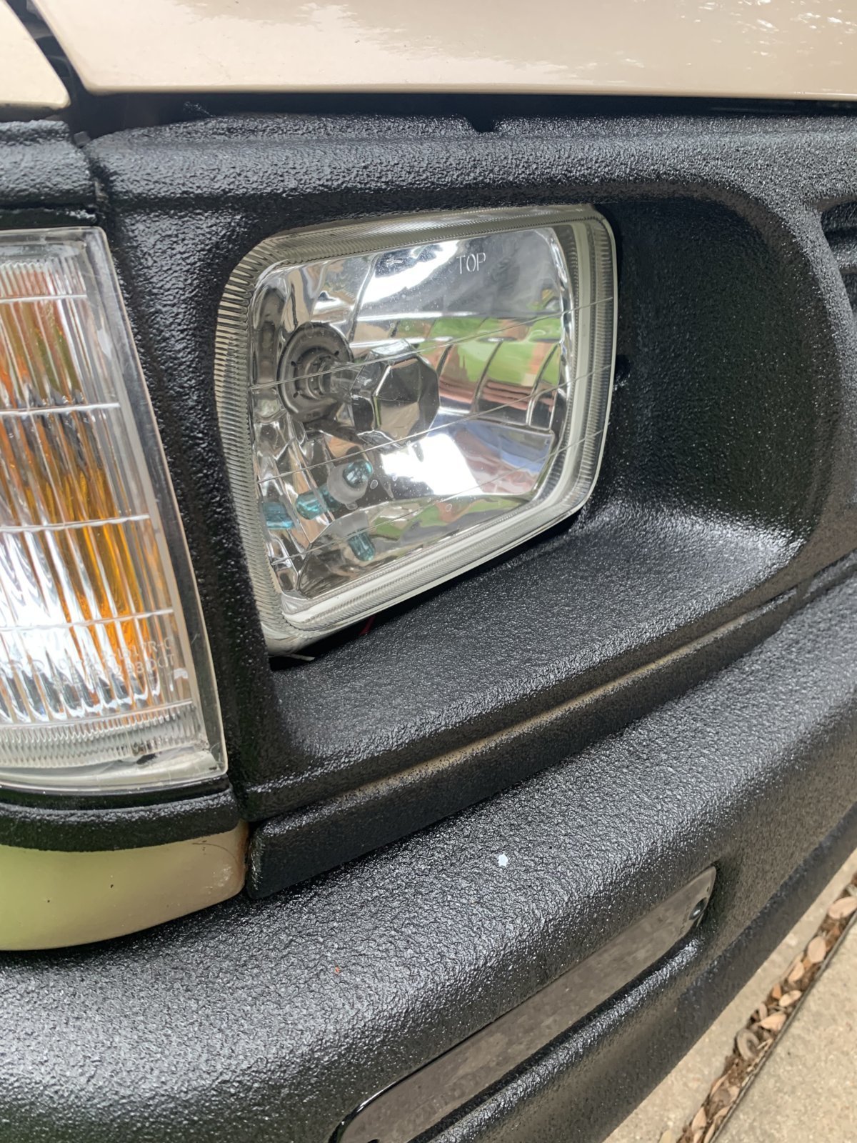

    Ebay
    Came with LED bulbs (didn’t use)
    Standard H4’s
    Plug and Play
    Did have to wire the ‘daytime running bulbs’
    And the best part…….GLASS lenses
