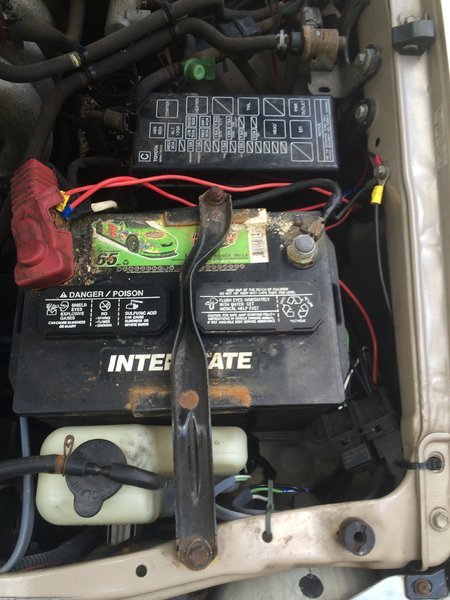

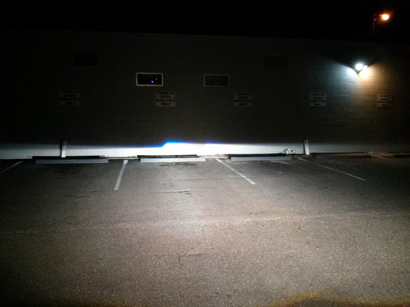

    Bumping this thread.
    Can someone post a picture of their wiring and how it connects to the battery?
    Depending on how it looks I may need to switch to a secondary fuse box as I've already got accessories linked to the battery.

    Positive goes right onto your "auxiliary" positive terminal. Your ground goes to the side of the engine bay right next to the battery, you'll see a bolt going into the sheet metal with one or two ring terminals already on it.

    Yep I've got that. Just looking for a visual is all

    Sorry the headlight wiring is a little messy, but I hope you get the idea.

    Perfect, that is exactly what I was looking for. Thank you!

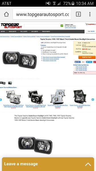

    Amy body have any reviews or insight on these?

    No. But I can guarantee you they will be significantly out-performed by Hella E-codes. I would literally bet the price of the Hellas on it. Anything blacking out the reflector lens is not a wide idea.

    Stay away from these cheap ones (fake projector ones and the ones with leds on sides). the dulled output and disco ball beam pattern is laughably bad.
    Only buy them if you want to retrofit them.
