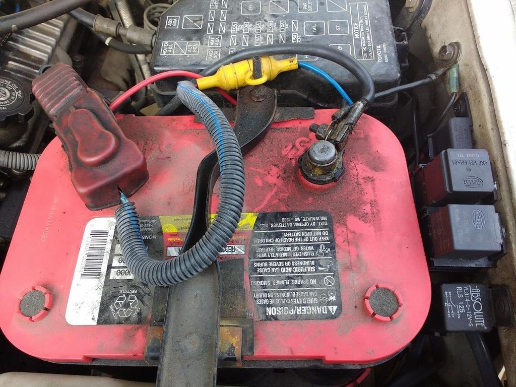

    Here's another shot of the wiring, including the relays and fuses, from my '99:
    From bottom right, relay for Hella Duo-Tone horns, then next 2 large Hella relays and fuse for the Rally harness upgrade. Red wire is direct to harness, black wire (unseen) from Neg post is direct to harness. Yellow fuse holder is for the horns.
