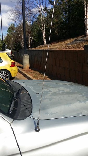

    Sorry keakar, but I think you misunderstood me about a 'bent' antenna.. basically I was trying to say that it does not mount 100% vertical - probably because of the 'universal' mounting hardware.
    I have attached a picture.
    Thanks

    ok, unless its mounted backwards then you need to replace it with the factory mount so it fits the fender, you cant "rig" that and have it look nice but I suppose you could make an angled spacer if you use a dremel tool on a pvc end cap like this http://www.homedepot.com/s/1%252F2%2522%253A%2520pvc%2520end%2520cap?NCNI-5 and it might look nice enough to be to your liking.
    you need to buy it at the dealer (super expensive like $75) or get the complete setup from the used parts sellers here for about $20

    Gil, the antenna assembly part # for 2001-2004 Tacomas is listed as: R 86300-04050. That assembly contains the mounting bezel, nut, and antenna mast. Should be able to order from any Toyo dealer..
