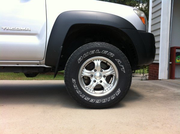

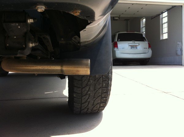

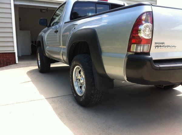

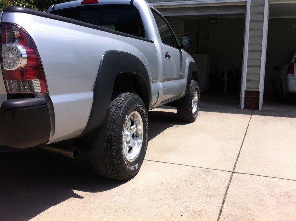

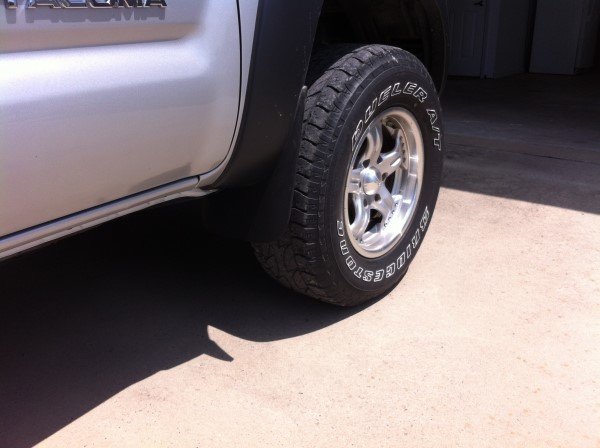

    anyways here's some pics of the finished work:
    8ygpp5_5bdc0655f63acd658a230fed52ac42c0b8d3216f.jpg 287ghl4_6552bb29cabdb1c90dbec88ce67bc9b5977167d8.jpg
    our6o1_dc75efc483179577bac31c1382e71585fb3b2358.jpg 313m44k_f07d9a02f54f8ecbb7b78837f34734705d2ba24b.jpg
    514i2t_b98c4b1218c8db95a3deae6f82ce22c1d1caea72.jpg 264hvu8_aa5179fb5d4d5fa43bc5b76811c73a042326a350.jpg

    i ordered a new set of flaps. i think i over did it as i heard some rocks hitting against the bottom of the truck after cutting them back so far.
    i'm going to shoot for a happy medium. of course stock size is too long and will scrape on things or even break off but i think i cut my flaps too short.
    i'm going to trim the new ones 4" off front and rear making the fronts 8" long and rears 6" long. i think this will be the best length to use. they will be short enough not to catch on curbs and such but still long enough to provide protection from pebbles and gravel and so forth.

    cut the new ones 3.5" off the fronts making them 8.5" long. cut the rears 4" off because of the cheesy 4x4 BS getting in the way. i cut them right above the 4x4 making them 6" long.
    i ordered a set of prerunner rear flaps and i'm going to cut them 2.5" making them 7.5" long to replace the rears though.
    this will be perfect. :D 8.5" in the front and 7.5" in the rear.
    i guess 9" in the front and 8" in the rear would work pretty well too though.
    this will make the front flaps 9.5" off the ground (driver's side 9" off the ground because of taco lean :D) and the rears will be 10.5" off the ground. plenty enough to clear things like curbs and whatever but still long enough to provide good protection.
    my truck is leveled out so a stock truck you could probably go a little shorter on the front flaps. maybe 7"-7 1/2" would be fine. my front end is lifted 1 1/2" so 8.5"-9" on the fronts works for me.

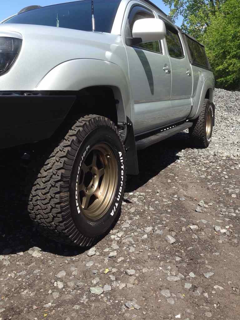

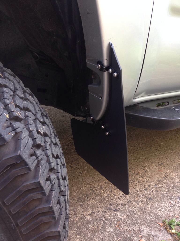

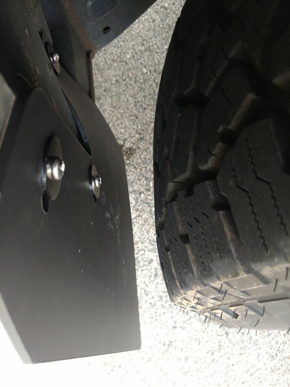

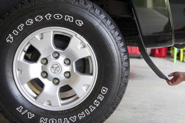

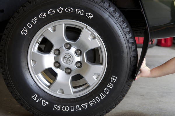

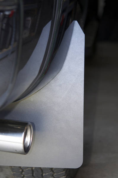

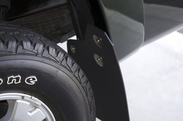

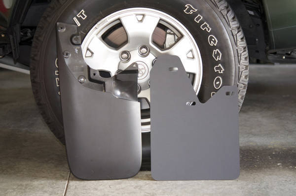

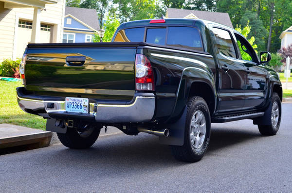

    Regular length Rokblokz came in the mail today and installed them shortly after. I think they hit a happy medium between ultra stiff like the stock mud guards, and flappy like the ones with the naked ladies off the back of an 18 wheeler. I had my daughter bend them front and back for pics so you can see how bendable they are.
    For me these are perfect and are exactly how they were described on their website when I ordered them. And they came with candy! Made me read the directions while I snacked on smarties.
    The install is identical for the front and rear and they are adjustable a little out or in. I opted to mount them directly in the middle. They mounting is easy and really solid. Going for a clean look so I opted not to add the stickers that came with the flaps. I think it is great that I had the option to leave them off.
    You can see the marks that the oem mud guards left. This is a '14 with only 9k miles.
    in adjustment
    out adjustment

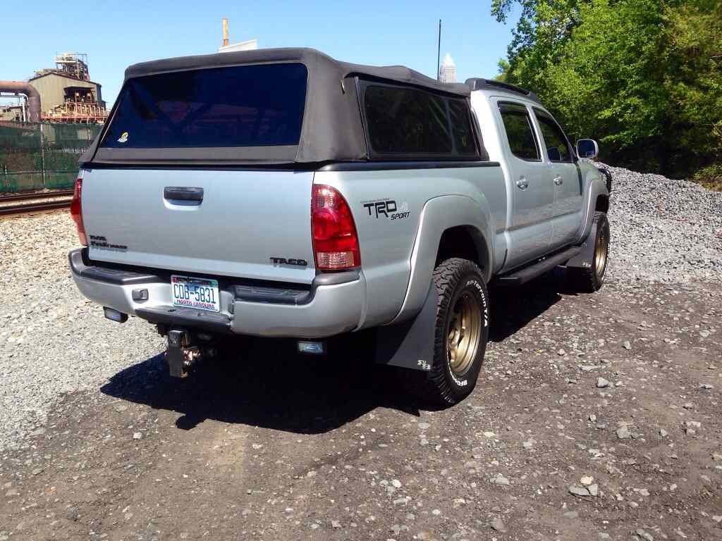

    ^Nice. I have the regular length oversized tire kit

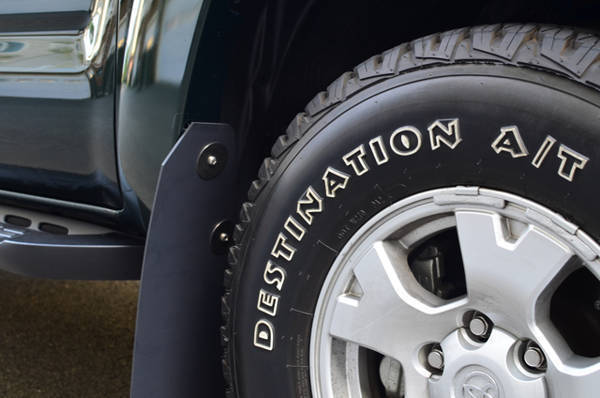

    Mine are the same regular length oversized tire kit from them, but they mount differently in the front:

    You do not have the oversize tire kit. My front flaps mount to the outside of the flare...

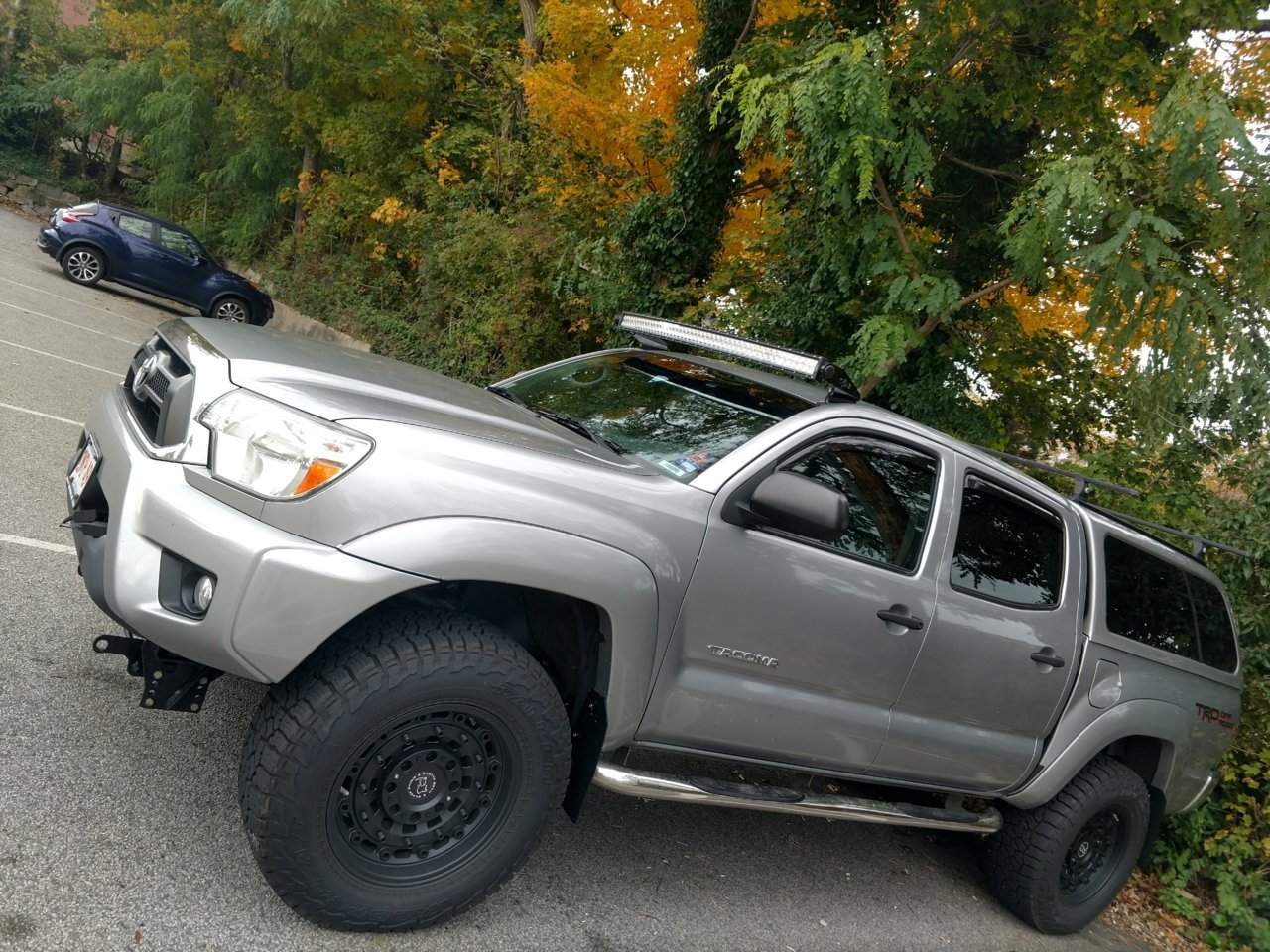

    Thank you for the guidance. These Rockblox mud guards are the best. I went with the shorter neater look with grey letters for obvious reasons. The wheels are as big as I can stuff in there and the stock were rubbing and the Rockblox we're also until. We put the heat gun to them and molded them in on the front. They look great! If you're doing a light bar make sure you seal underneath. Drop the headliner and use windshield putty. No more water. Thanks againIMG_20181101_101719707.jpg IMG_20181101_101719707.jpg IMG_20181101_101757918_HDR.jpg
