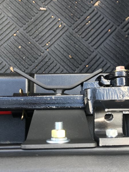

  7. Jan 12, 2017 at 11:54 AM
    #47
    nudavinci64
    nudavinci64 Robert @ Holy Horsepower
    Nov 14, 2013
    #116533
    10,144
    Robert
    San Mateo/Cayucos, CA
    13 S/C TRD OffRoad 4x4
    Boosted Money Pit....
    Do you have a picture of the full, front and rear of how it sits in the bed? I am debating on the 40's or 60" mount as well for my SB. Figure mind as well grab the 60" if it fits but again seems like the 40s one will do just fine in majority of cases.
