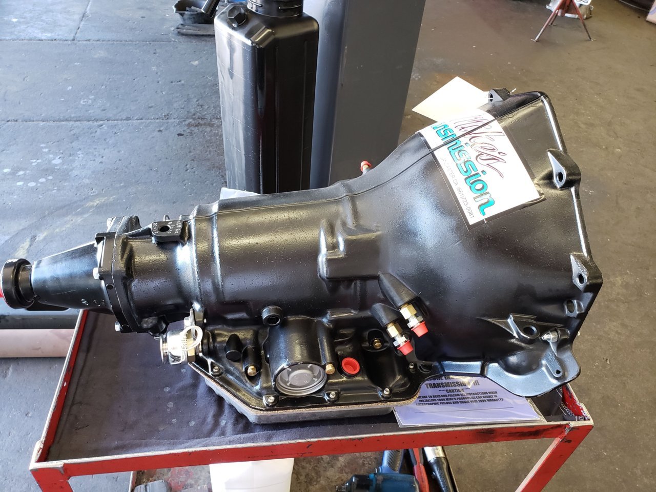

    US Marine
    US Marine Semper Fi
    Mar 24, 2016
    #182227
    14,746
    Chuck
    Gallatin Tennessee
    02 Pre Runner supercharged 4cyl
    TRD supercharger , Doug Thorley header , K&N CAI 265/75-16 Toyo open country mud terrain , 15x8 Method Racing wheels , Rancho 3" lift , 4.88 gears , Detroit Locker
    Try to keep a racing auto trans from grenading !!! , insanely high line pressure ,transbrake , reverse manual valve body and 4500 stall converter

    US Marine
    US Marine Semper Fi
    Mar 24, 2016
    #182227
    14,746
    Chuck
    Gallatin Tennessee
    How about a Turbo 350 with full manual reverse valve body and Transbrake capable of supporting 1k hp
