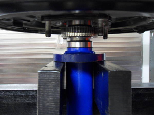

    That's a good idea if your press is beefy enough to press all four pieces at once and you're able to get the snap ring out without scratching the axle flange too badly.
    I used the Durasolid tool to do my press work (kind of pricey, the cut-off junk axle housing works well too) and I used a bearing splitter on the end of it to press the ABS ring and the inboard bearing retainer off in one shot.
    You have to pound out two of the backing plate studs to make room for the splitter, but they come out and go back in easily. Other than this or your 4-at-once method requires cutting off the ABS ring and retainer and that's an expensive pain in the butt.

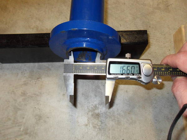

    That tool is pretty slick and $120 isn't to bad.
    I have a couple questions. In the specs it says "tube I.D. 1.5". I measure the machined area on the shaft at roughly 1.57".:confused: How do you deal with the inner retainer?
    I really like the threaded feature. Do you happen to know off hand the thread type? Fine, course, Acme, I don't really need the exact size, just the type. Thanks

    They should've listed the actual I.D. instead of the trade size. It's actually 1.66".
    This fits over the machined part of the shaft and its size works well as the press sleeve for reinstalling the retainers and ABS ring.
    Notice the inboard retainer is pressed on 'backwards'. I used the redesigned oil seals so that's intentional:

    Ah, sorry. I didn't take a picture of that but it's the same procedure as using the SST in the FSM. In these two pictures visualize it without the bearing splitter and standoffs, with the 4 original axle backing plate studs now protruding through the holes in the lower blue plate of the tool (4 of the multiple holes line up perfectly with the studs.
    After the snap ring, ABS ring and inboard retainer have been removed, the lower blue plate of the tool now sits on top of the outboard retainer. There are enough threads of the studs protruding through the tool's bottom plate to install the original nuts that hold the axle assembly to the axle housing. With the nuts holding the tool to the axle assembly, the tool is installed in the press exactly like the first picture and the axle is pressed out of the bearing as in the FSM. The outboard retainer is just along for the ride here so it will be pressed off in the process.
