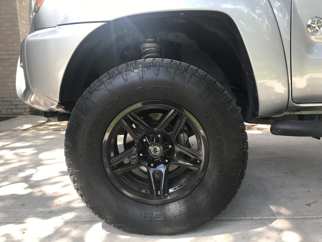

    That’s a 285/70/17 on a 17x8.5 -10. I’ll assume you want it to poke out more. EBD7F32E-4A79-4FC0-879C-5D964C0DE7C7.jpg

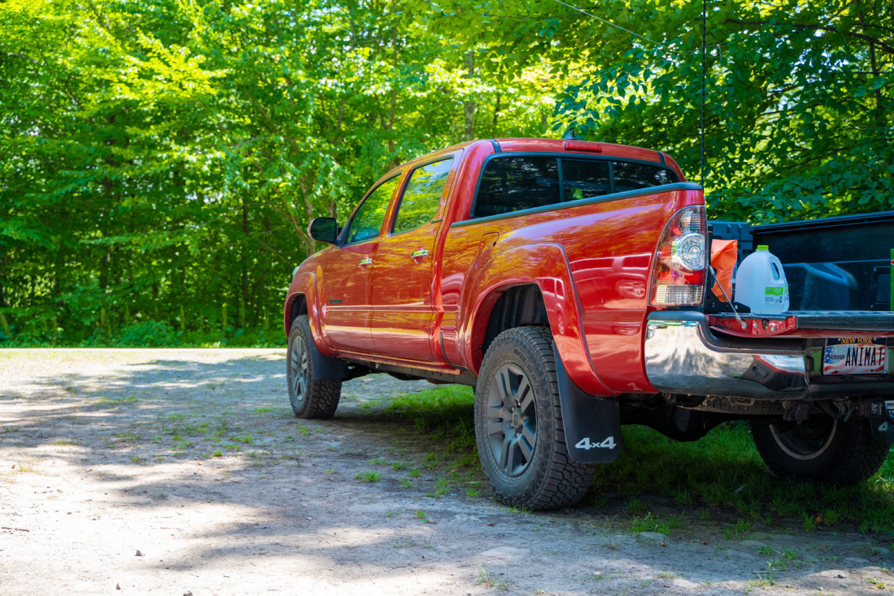

    This is current set up

    You’ll be fine from rubbing the uca with a wheel 8-8.5 0 to -10. Here the wheel, unfortunately it doesn’t come in an 18. DA578FD6-B898-41FB-99C9-08985EF2925A.jpg

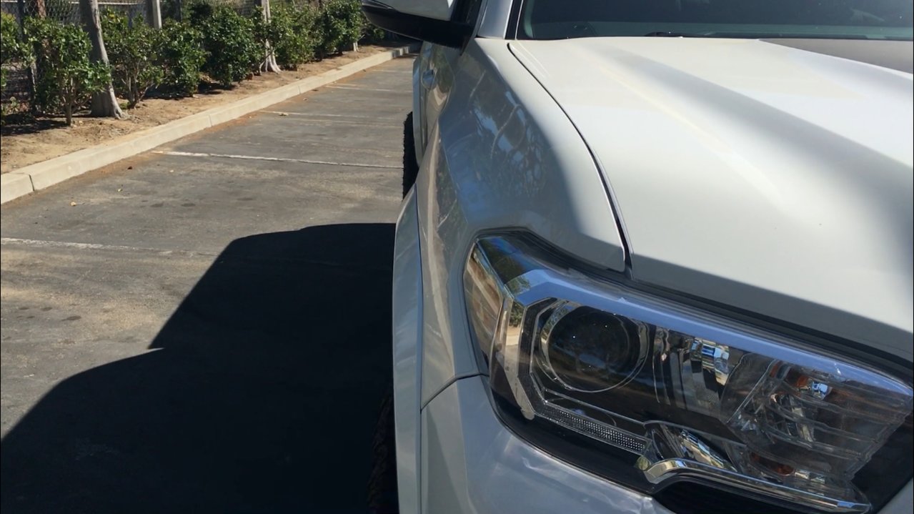

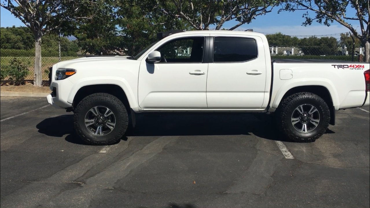

  15. Sep 9, 2019 at 12:44 PM
    wheelin fun
    wheelin fun Active Member
    Sep 9, 2019
    #304727
    39
    Steve
    2017 Tacoma 4x4 Sport
    I have stock TRD wheels with Spidertrax 1.25 spacers and Milestar Patagonia 285/70/17 and Bilstein at 3rd clip. No rubbing. Removed mud flaps
