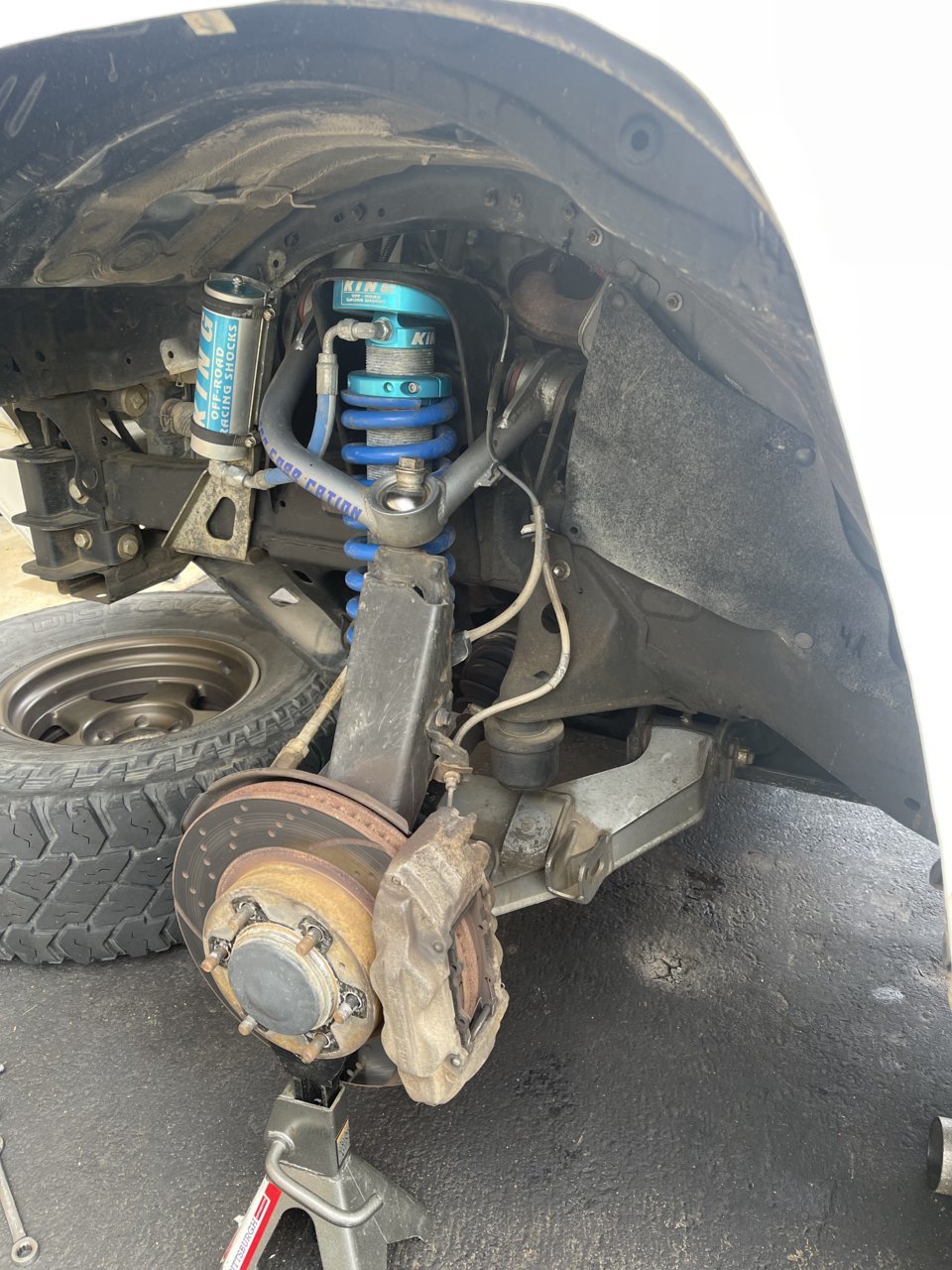

    TC has newer versions called the Expedition series. They retain your steering stops. Also dual shock and single are the same price, the last time I checked. I have the dual shock, and they are awesome. No complaints.
