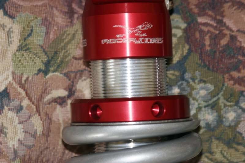

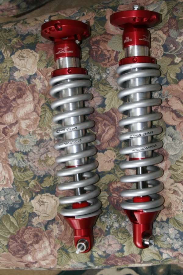

    Adjustable coilover shocks replace the stock coils and shocks on the front of your truck. They have a threaded collar that is adjusted up or down the threaded shock body to set the exact amount of needed lift in front. Typically between 1"-2.5". The CO manufacturers claim adjustability of 0"-3".
