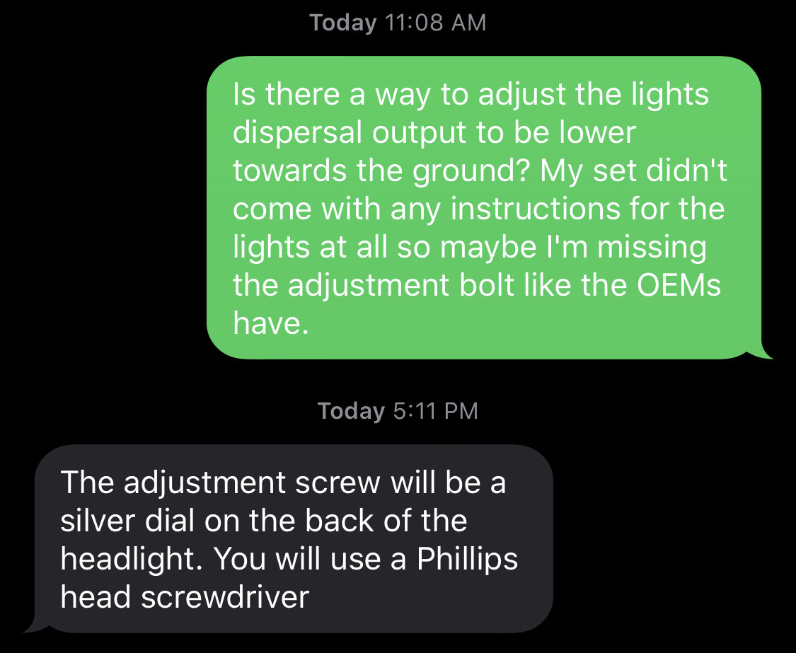

    I become increasingly bothered that the taco community was disappointed in a fellow taco driver being an ahole on the road blinding people. So I wrote Alpharex and they responded quickly through their text message support line. Image shows conversation.
    Bottom line there is a way to adjust the lights just didn’t know that was used for adjusting the lights. Additionally after looking at some of the advise you guys offered I didn’t account for my lift. My back end is slightly lower than the front haven’t tackled that cosmetic flaw yet but that can be contributing to the lights slightly upwards too. So tonight I’ll do the adjustment and update again. Thanks for the input.
