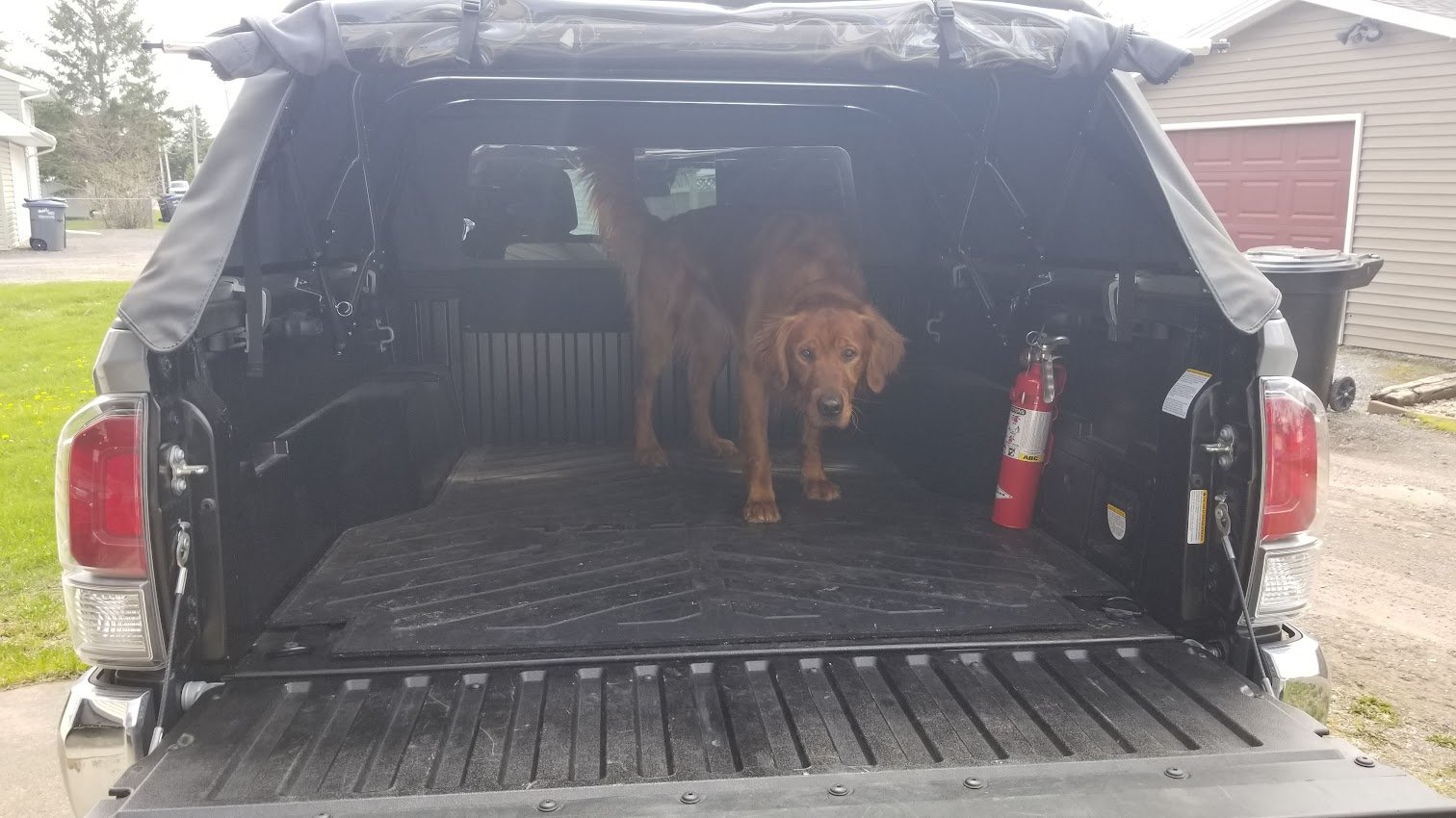

    I've had my ST since 2019. No fading or cracking. I hit it with Aerospace 303 Protectant twice a year. I don't touch the windows if it gets into the teens.
    Pretty easy.
    On security. Someone broke into mine once by properly opening it. Rooted through hundreds of $$ of recovery gear and such and only stole a $7 Costco InstaCrate.
    I do see lots of hard canopies with broken out windows.

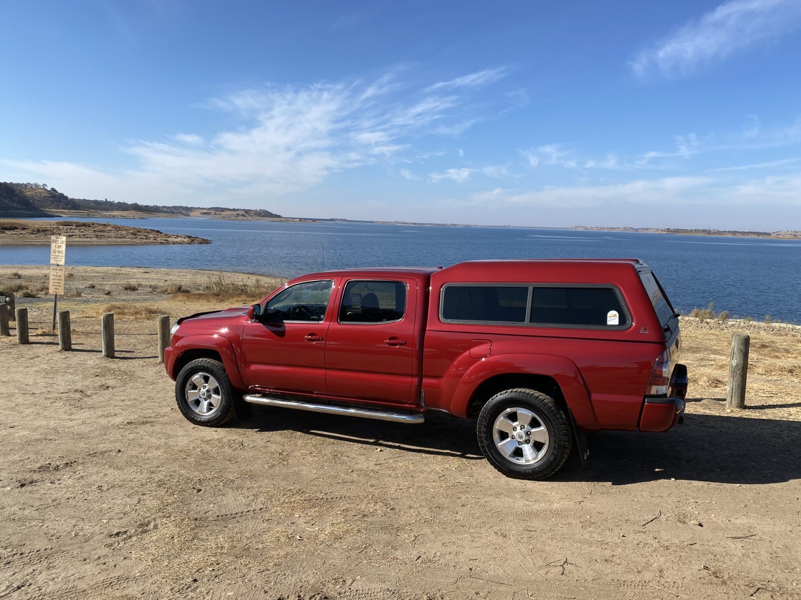

    I have a hard top. Not being able to haul big stuff is a con sometimes and a pro other times. I.e., if I need to haul furniture I need to rent a trailer (con); if someone wants me to haul their furniture, it can’t fit (pro).

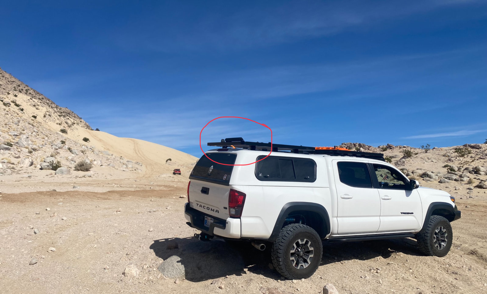

    Dayton wires, flux-capacitor, port-a-potty
    I run a snug top with racks, and haul kayaks/paddle boards on them. Front runner has a “roller” attachment for the rack, it allows me to load everything on the roof single-handedly(circled in red in photo). In case you haven’t seen that setup before.IMG_0267.jpg

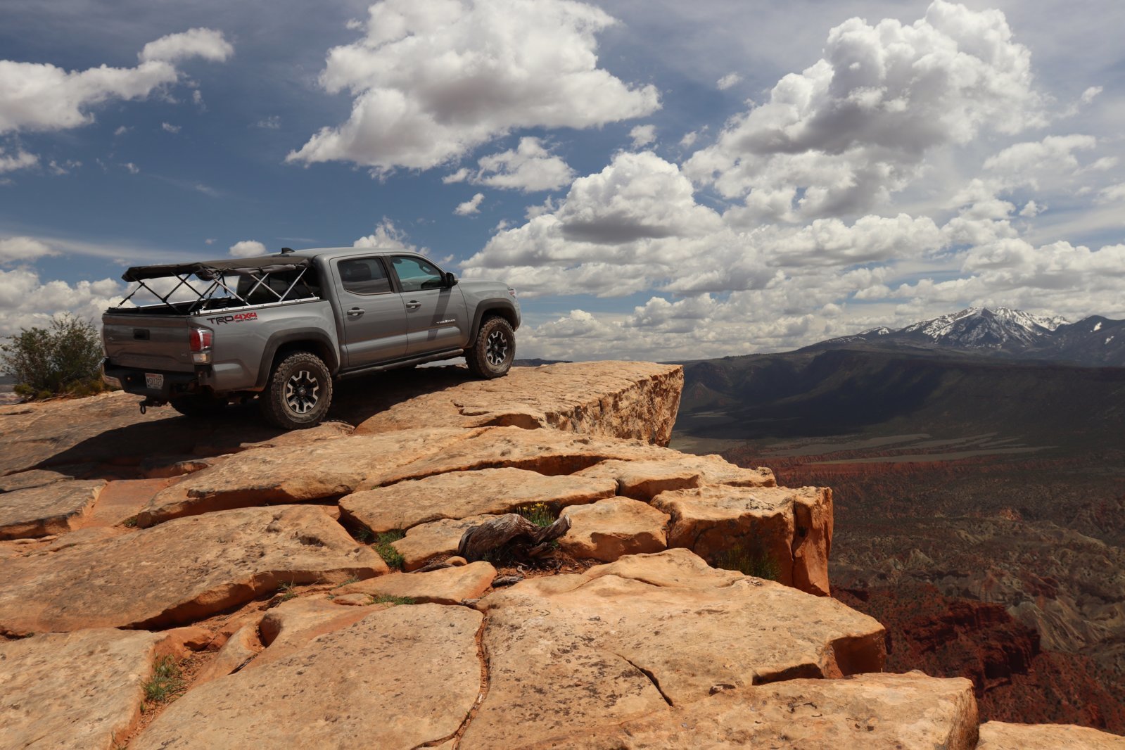

    I got a softopper strictly for camping purposes paired with a topper tent and being able to haul things in the bed without them flying out or getting wet in the rain.
    I also needed something very easily removed in case I need all bed space or hauling something larger than what would fit in a cap. For my needs, a softopper was the perfect choice and the right price.
    Made no change in wind noise or fuel mileage. Been over 90mph and no issues.
