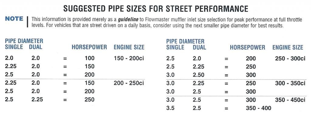

    Found this. So for the 2.7L, a 2.25" pipe is about right. 2.5" for the V6 (4.0L). Notice that the note says this is for full throttle; you definitely do not want to go bigger than what is shown.
    One day at work, I noticed that I parked next to a Tacoma with the V6. I measured the V6 pipe diameter (yes, I make sure it was cool first!). Same size as my I4! Both are 60 mm (just under 2-3/8"). So it's a bit small for the 4.0L and a little big for the 2.7L. I guess it's cheaper/easier for Toyota to make just one diameter pipe for all Tacomas?

    I don't quite understand the chart. If someone unknowing were to look at that they would think to get a 3.5 diameter? Where's the 4.0 fall under? Which rpm range are these for? If the v6 diameter is small already isn't that good?
    Thanks for the chart but someone like me needs it spelled out!

    Pretty simple to understand. Since our Tacoma is a 4.0L engine, converting that to standard size: 244CID aka 244 Cubic Inch Displacement. Then look at the chart, we would fall in the 200-250 CI range and since most of us run the single piping setup we would use the 2.5 at 250 hp.
    BTW I wouldn't run anything bigger then 2.5" unless you're boosted i.e; supercharger or turbo.

    That takes care of the engine size. Next, which rpm range is this? Most likely more towards WOT since that is what most people are in the market for. Since our diameters are closer to 2.25, does that mean our exhausts are already tuned for low range power?

    Yes and yes. Correct our engine exhaust piping size is ideal for the low range power. Some guys just like to change out the muffler for a less restrictive type instead. I wouldn't recommend the 2.5" piping unless you're boosted. You will feel a little lost of the low end torque. What about the maf calibrator?
