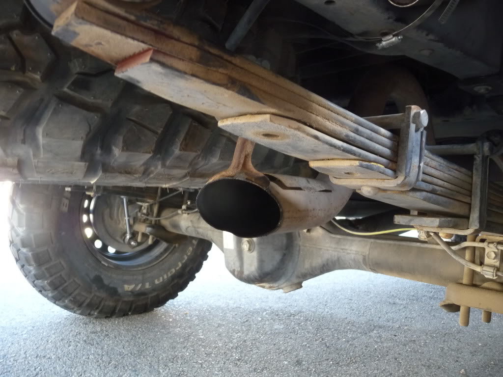

    just a couple comfort items.
    Here is where I chopped mine, no smell and I haven't squashed it yet however it still hits a rock once in a while, you can see the last ding there. I thought I would try cutting it there so I could retain the hanger.

    One pro is that you will avoid a rock smashing it into your quarter panel and then getting jammed on the frame when your truck only has 4,000 miles on it. Happened to a ...uh... "friend of mine" :anonymous:
    As for the gases in the cab: If you have a shell and sleep in there, I would find some way to get it to exit beyond the reaches of the undercarriage, as there is going to be some build-up in there (as Ridgerunner pointed out, some fumes you can't smell). Maybe side-exit, maybe rear-exit. But definitely exit from something other than underneath. Now, if you don't have a shell, or don't ever sleep in the shell, then don't worry about it.

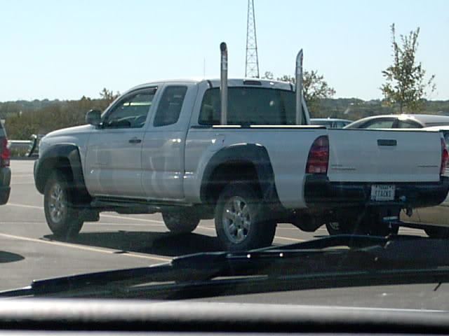

    I was not trying to offend or freak anyone out with my "possible" cons. Since mine is also chopped short, I am always aware of potential problems (mine was chopped because a previous owner cut the entire pipe out behind the cat).
    While pretty much all of you have mentioned no "exhaust fumes" in the cab, you have to remember that carbon monoxide has no odor. You can't smell it. So even if you DID get some inside the cab, you wouldn't know it. While the risks are low in a pickup, it is still there. I just wanted the OP to know the facts. I was not trying to "freak out" anyone.

    Good point Bill.
    I made sure to chop mine square, on a straight run of pipe. That way, if I chose or needed to, I could hang the tailpipe from the stock hanger and re-connect the pipe with a band clamp at the cut.

    Now THOSE would look cool on a Tacoma. Not that I would do it myself.

    Hahaha so ur the guy I laugh at! It looks gay as fuck! There's a guy here around town that has some and I'm sure his friends never ride with him

    I hope you mean that in jest. Otherwise keep your comments to yourself. If you paid any damn attention I said they would look cool, but I wouldn't do that to my truck. That means (at least to any intelligent person out there) that I have NOT got those on my truck, so no, you didn't see me driving around.
    To each his own is what I say. No need to interject your "gay as fuck" comment here. If you don't like them, fine. :brianr:

    It looks strange, but still, it has an interesting look to it.

    no that was not a comment direct exactly at u! Yes i can read and obviously it is not ur truck i see because u do not live in my town . . . . . . i was being more facetious then anything about the situation. And everyone has their own opinion, mine is: This . . . . . . . .
    looks GAY AS FUCK to me so those are the words i choose to use. Thank u for your time sir ;)

    It looks white trash.
