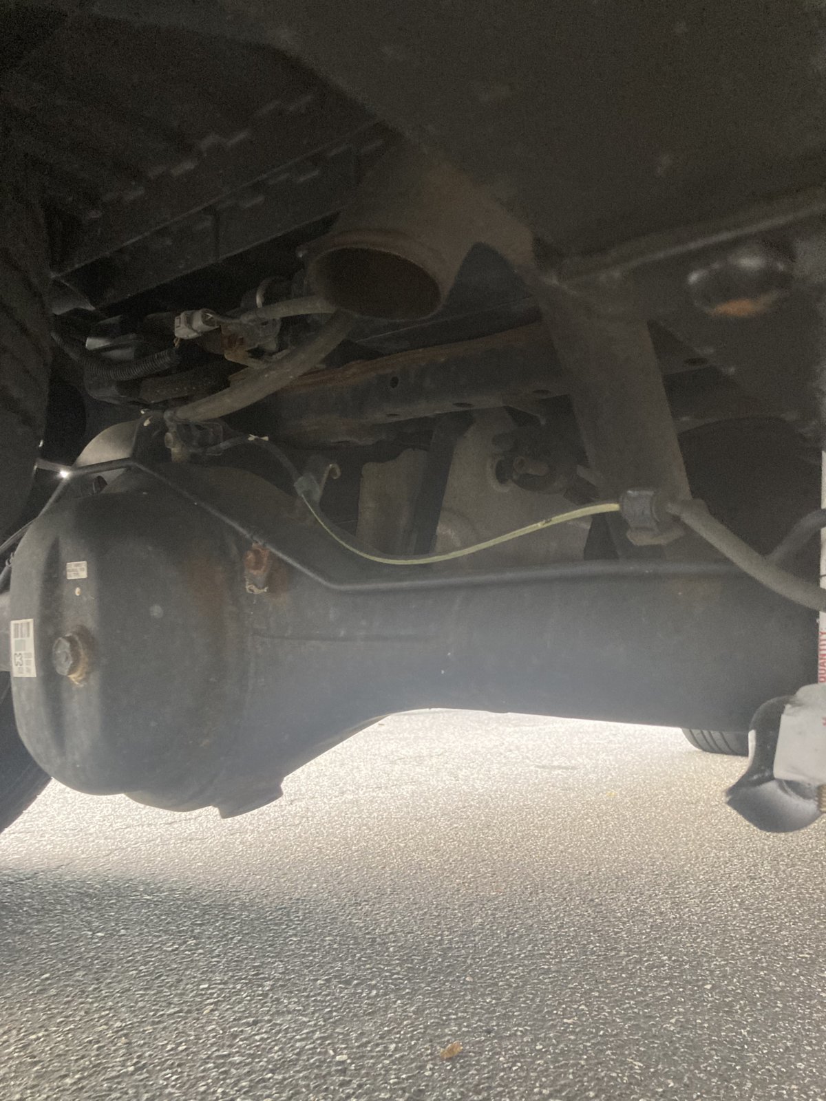

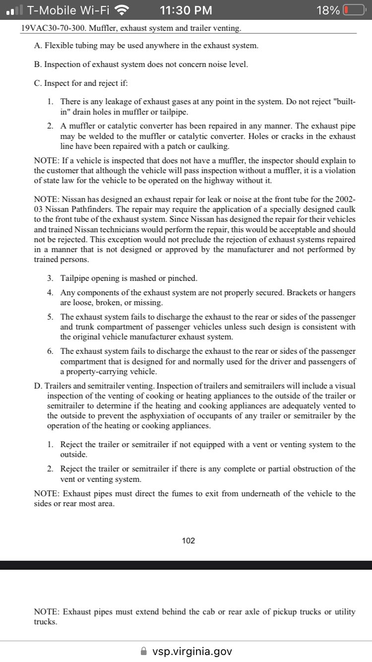

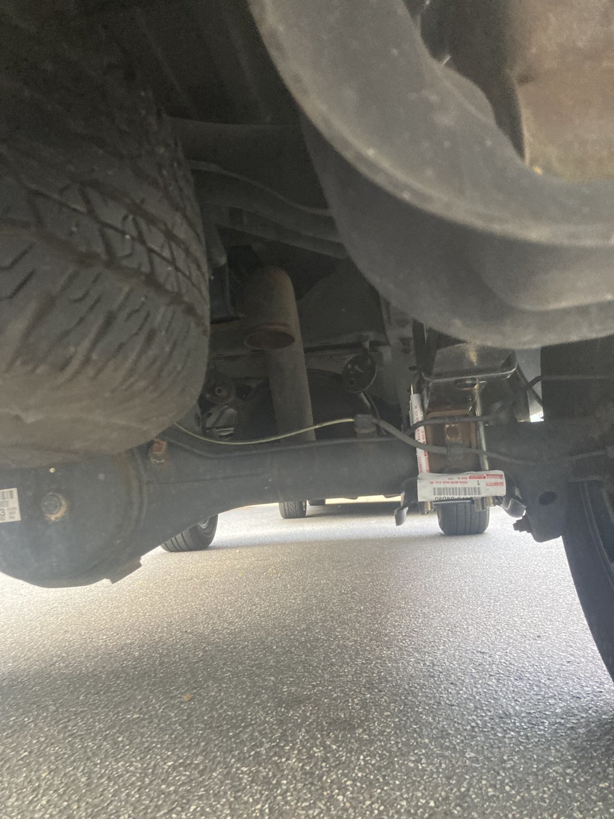

    Gonna revive this thread if I can:
    My wife’s 09 Tacoma Virginia state inspection was rejected for exhaust. The exhaust pipe was chopped at some point before we bought it (I was unaware and thought it was manufactured that way). The inspector rejected it because there is a shell on it and the exhaust fumes may get into the shell. I believe this is the 3rd inspection since cap install and first time this issue came up.
    Naturally I’m like wtf so I start scouring the inspection manual and find the following: 7504A8A5-957C-4333-82EA-4F5EE27BE635.png 7BD6761D-782F-452F-810C-6E771C760D8B.jpg 6400B9C0-52CE-48C3-86AB-FCD053A6F36D.jpg
    Apparently the guy has been inspecting cars for 30 years but I think this shit is bogus.
    Guess this is a con of chopped exhaust, what do you guys think?

    1. Ask him to point to the "shell." (No such thing, except where it crosses under the transmission...and even then, it's welded shut on both ends)
    2. The law's wording makes no mention of whether the exhaust system must be original, stock, aftermarket, modified, or anything else. It simply states how it must perform, and a few specific items that are prohibited.
    2a. The law says nothing about judgement calls for things that "may" happen. The inspector "may" have worked 30 years in an inspection shop as a janitor, and is only filling in this week for the regular guy who actually knows anything.
    3. The outlet meets BOTH parts of the "behind the cab or axle" part, despite the wording leaving the option of one or the other.
    Either file a complaint with the state, or find a guy who knows what the hell he's doing.

    Thanks for reply. Yeh I definitely want to report to state police because I’m stubborn and don’t wanna pay again to get it inspected by my normal guy. I just brought it to Firestone for wheel balance, rotation and alignment. I thought hey might as well get it inspected.
    Anyway, my only other concern is the section that states “to the sides or rear most area.”

    Last line in your initial post has a note that says exhaust pipes must extend behind the cab or rear axle of pickup trucks or utility trucks. I'd say you're good. A cab is where the driver and passengers sit, the bed of the truck doesn't transport people as it's primary function. Reread C-6 which further emphasizes my point, passenger compartment. Your vehicle satisfies everything outlined in that statement you posted.

    You're reading it wrong, or rather incompletely.
    The part about "sides and rearmost area" specifically refers to passenger vehicles (#5).
    Pickup trucks (worded as "property-carrying vehicle") get their own specific callout, where it says behind the "passenger compartment" (#6), and also a separate note about the passenger compartment OR the rear axle (important legal clarification about the difference between "or" and "and"). The bed is the cargo compartment. It cannot legally be considered a passenger compartment unless DOT-approved seats and seatbelts are installed in a DOT-approved manner. Otherwise, what differentiates a camper shell from a tonneau cover or a tarp?? Or from a passenger vehicle's trunk, for that matter??

    I can't imagine considering the cargo space inside a bed shell as a passenger compartment. Riding down the road in there would quickly get a ticket. But if the space is set up as a camp area, I can see the concern. You might leave the truck idling to maintain a battery or get some heat.
    Its certainly worth brining it to the attention of the authorities to get clarification though...

    Got a sticker! Didn’t need to remove cap or anything. Pulled up next to his car, we shook hands, he took a look at the exhaust and told me I was spot on with the inspection manual and that the exhaust just needed to go passed the passenger compartment. He apparently consulted some master troopers that notified him it wasn’t grounds to reject the exhaust.
    Anyway, brought my key into Firestone and the inspector was pissed! Regardless I got my sticker without having to take it to my usual inspector (and pay again) or remove the cap.
