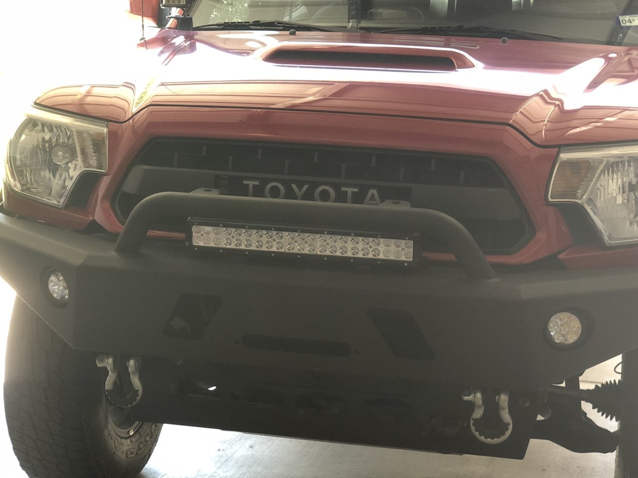

    Do what i did. Hit a deer (on accident), then take your insurance check and buy a plate bumper...no out of pocket $$$.
    Billy at bruteforce customized my bumper to take the larger fog lights and weigh in around 100lbs

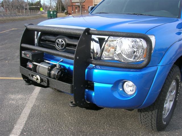

    Warn makes a "Transformer" brush-guard unit that can be built-on as you go. It has a provision for adding a winch later, many options - and importantly - it is based on a frame mount that has an upper brace. Can also be used to provide a front box hitch. if I were to build one on my own - I would go to school on their design, it goes right over the existing Taco bumper and has its own structure.
