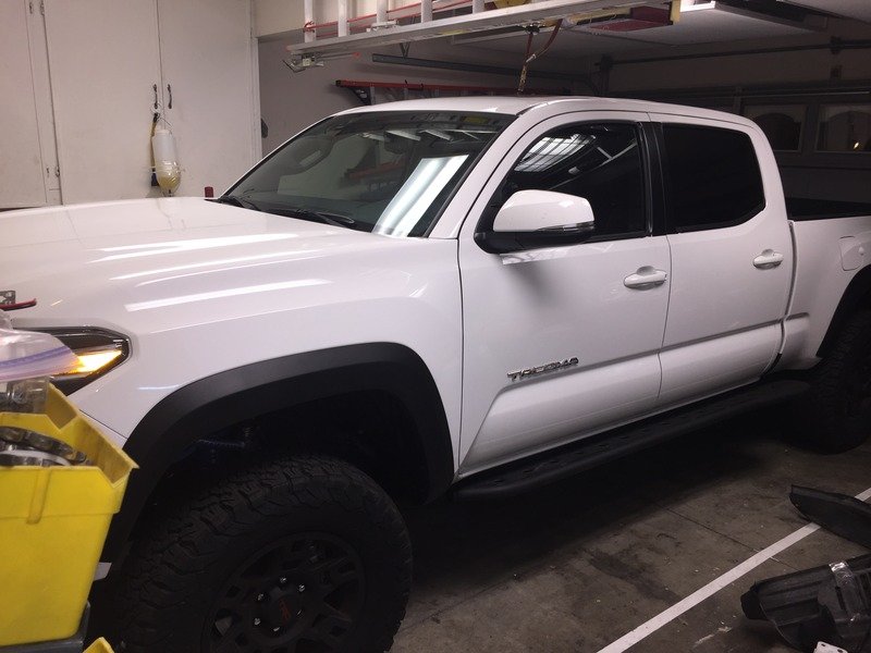

    This is what I did. Well close. I used 3m stair tape stuff from Home Depot. Been on there for a winter and almost a year. Stil looks new.
    Sliders are just rattle canned with bedliner spray.
