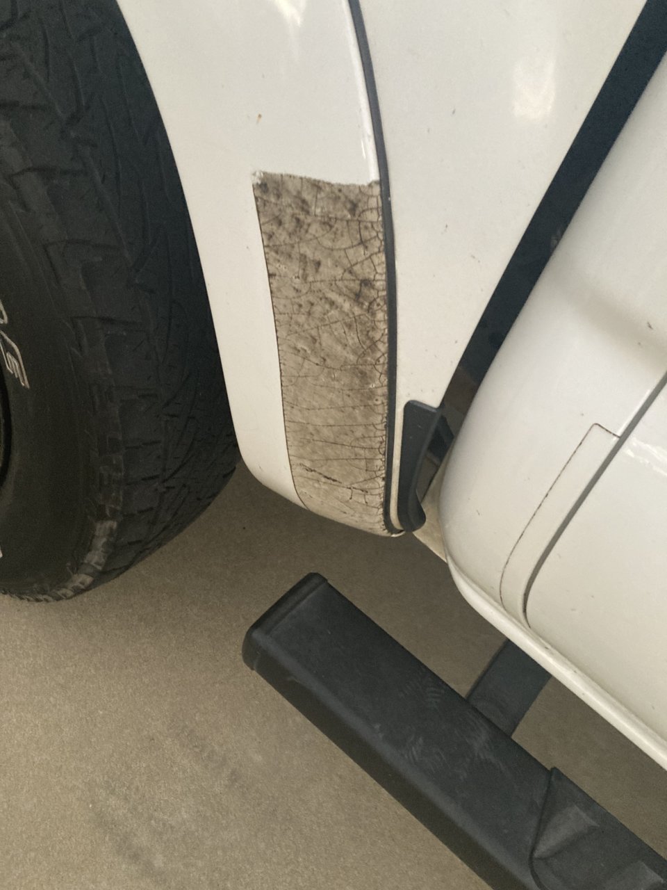

    Anyone have experience removing these things? Would rather not mess up my paint haha.

    Ouch, that looks rough. I definitely recommend using a heat gun or at worst a hair dryer.

    Hair dryer, plastic razor or small putty knife blade, mineral spirits, lots of patience.
    You *may* have already waited too long to have flawless paint left. In the area of the rocker that has the chip guard application I lost a few streaks of the color coat.

    Yeah I just bought my first Tacoma this week. Man I’m beyond happy with it but I would like to get this little issue off because, really, it’s the only thing wrong with the truck!

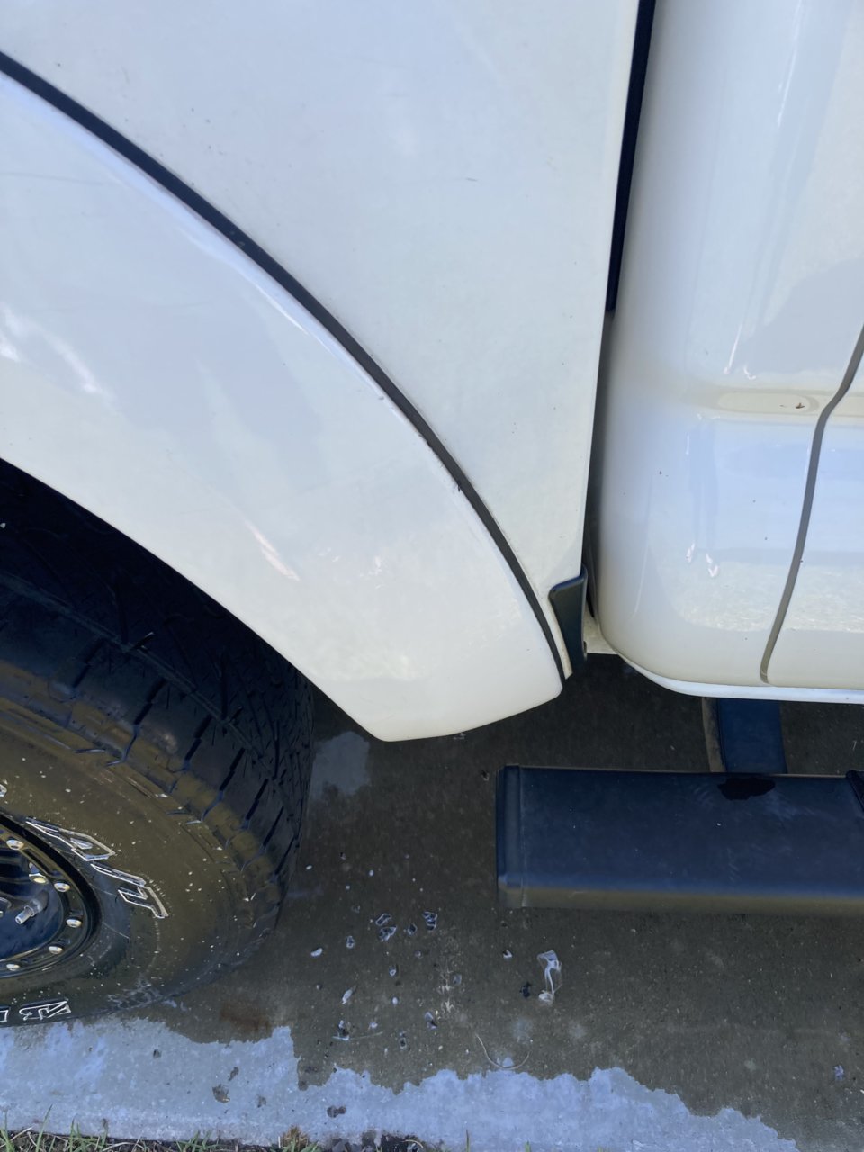

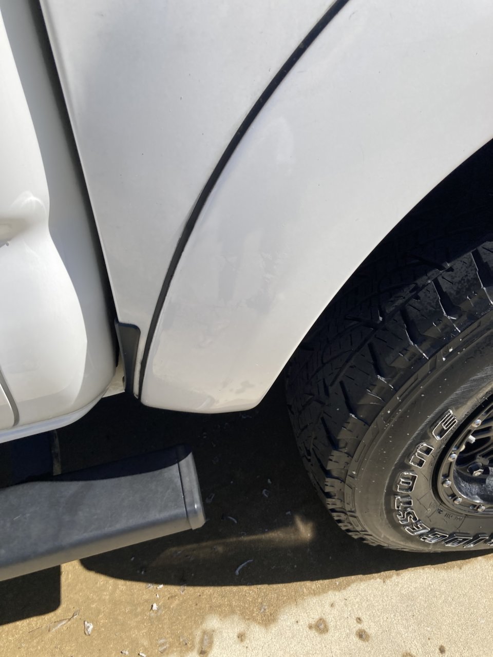

    Update boys and girls. 3M a plastic razor and 2 hours of elbow grease. As good as new. Well close haha
