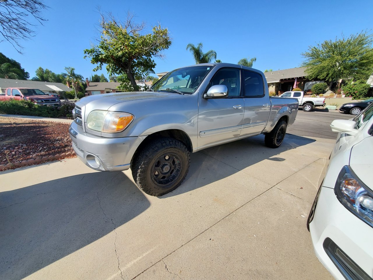

    bought a 2005 tubdra 4x4. 2 previous owners, 1st owner had it for 36k miles.
    Paid 8,500. Zero rust, socal truck currently has 187k miles. How did i do? Only scare thing is I don't think the timing belt has ever been done yet so I'm doing it asap. Anything else to replace?
