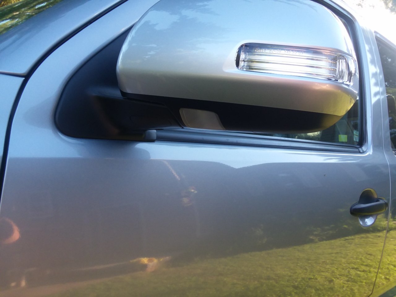

    I did the whole enchilada as I wanted heated mirrors, color match, turn signals and puddle lights. Lots of wiring, and had to use 2013 4 runner mirrors. Cool as all get out, but a big job. PM me if you are interested in going that direction...

    So this was a while back and I did not take pictures or keep notes for a write up; however, that said I can give some tips. I bought 2013 4 runner mirrors-twice, as there is a mid year change that no one said anything about and the late ones are different! The early and 2012, 11, 10 etc. fit, but not the late 2013 mirrors. I used my factory Tacoma perches (the part that mounts to the doors) and the upper mirror part to the 4 runner-yes, there is a lot of dis-assembly/re assembly and wires must be cut. The mirrors and perches assemble like they were meant for each other.
    I had the factory wiring in my truck for the sport mirrors, so that was an easy rewire for the turn signals and mirror functions. I ran wires for the puddle lights and mirrors. The puddle lights went into the dome light circuit which I think I found behind the radio. The heat was from scratch and I used a fancy expensive timed relay so they turn on and run for 20 minutes and shut off no matter what the switch says and a switch from MESO (I think). I ended up buying factory mirrors the second time (expensive) vs the ebay purchase the first time (cheap). The cover is a factory Toyota color match part. Change the bulbs to the puddle lights BEFORE you button it up as the lights are dim and yellow. I wish I had as I have yet to figure out how to get to them again... took me most of two days with all the wiring and such. Sorry not more for you but I never intended a write up... just kept track of the the pit falls. This is a middling to easy conversion just lots to do and some thinking with the mirror dis-assembly and wire plug changes from the 4 Runner to the Tacoma plug.
