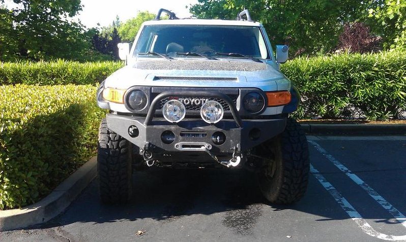

    Hella 700FFs converted to HID and mounted on the bumper. better pix later.

    Hey Seth, did you happen to take any pictures or anything when doing your projector retrofit?

    Sorry I didnt, I always forget to take the time to take pictures because im so involved in getting the project done. its really not too difficult with the morimoto minis. Just remember to put them back on the FJ and align them before you put the lenses back on because there is some slop in the part the guides them into the H4 opening.
