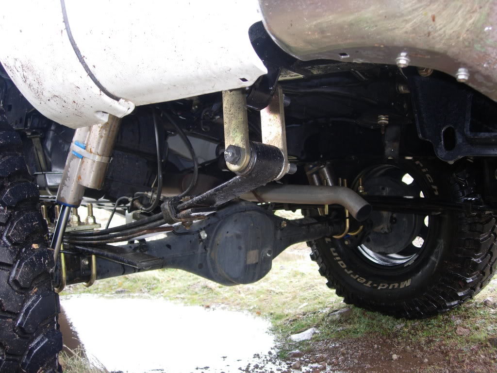

    shackles hold your leaf packs to the frame. They allow the ends of the leaf packs to come towards each other as they flex. However, stock tacoma shackles are inverted, so they hang up instead of down. If you get shackles that hang down, it will allow you to gain about 1/2" or more of lift (depending on the shackles).

    where do i buy that kit? I want it! lol
