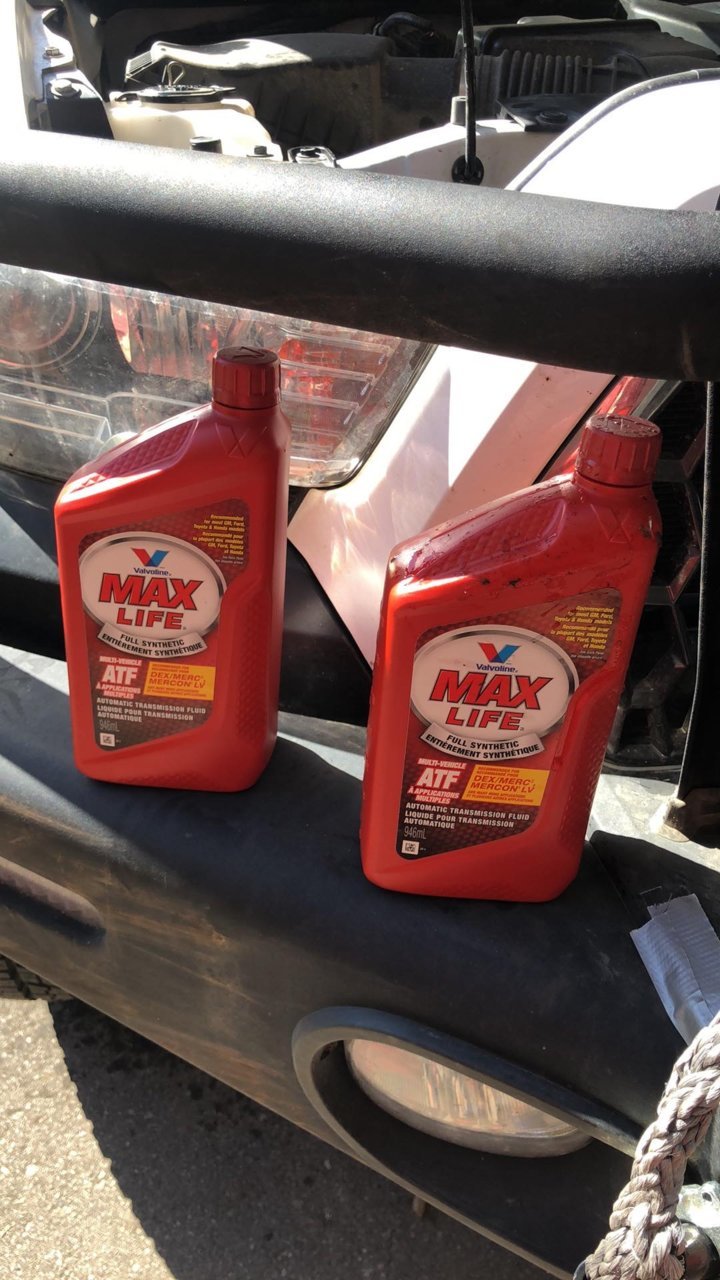

    So this beautiful sunny Saturday I decided to do a P/S fluid change at 60K miles on my not so beautiful and mostly beat to shit turd gen. I think it's a good time to get it done and why not, since the fluid is cheap and it takes half an hour to do it.
    some things to note:
    - This is a second steering rack on my truck, the first one failed at 30K miles (with P rated 265s!!!) and Toyota installed another one, so basically this rack got only 30K miles.
    - I am now on 35s, but rack never had leaks, nor fluid level ever went down and had to be added.

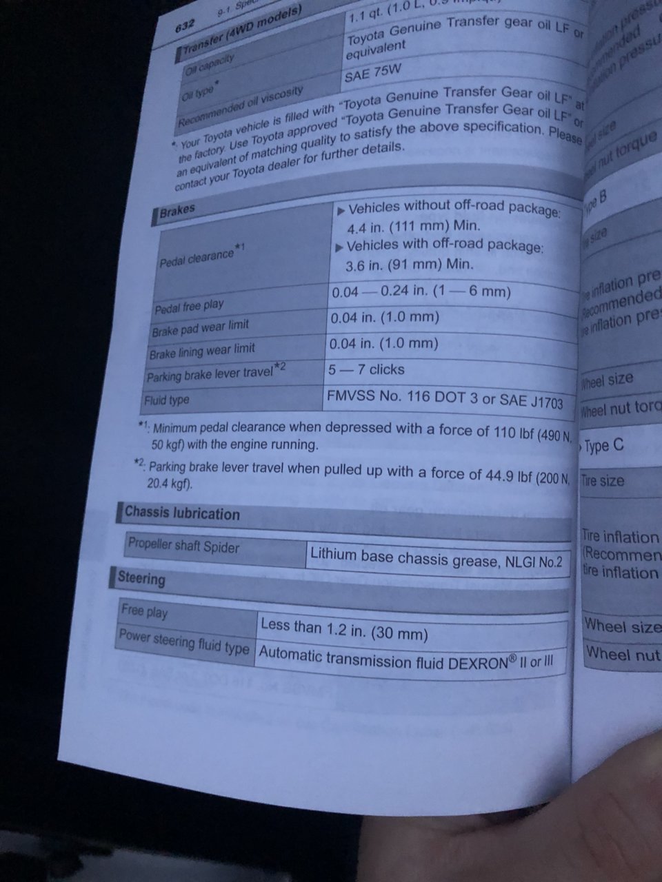

    First thing first, I open owners manual to check what fluid Toyota recommends and we are seeing it's the Dex II or III

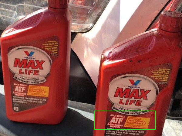

    So I go to the nearest NAPA and grab 2 bottles of ATF fluid that many here seems to be using. Says Dex III compatible so must be fine.

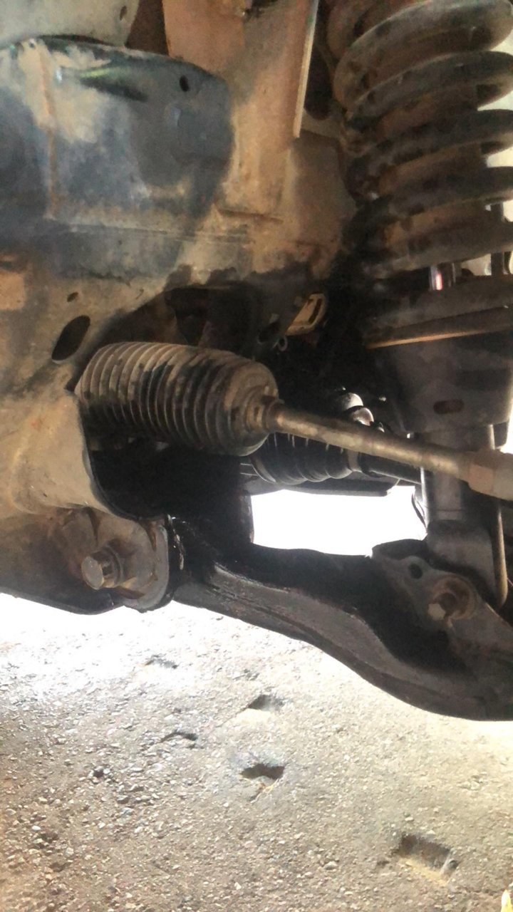

    After disconnecting return line, turning wheels while engine off and making sure reservoir never gets empty I complete full flush and have clean atf fluid coming from return line. I put all back together, top it off, keep the remaining atf fluid in the truck and heading our to catch some MTB trails out of town. It's close to 2 hour drive for me so I get there and start feeling steering being stiff at turns. After pulling to a parking spot I decide to quick check on the fluid level and see how we are doing there, to my surprise the reservoir is completely empty. I start looking around to locate where the leak is, and what do we see there. It's leaking right from the rack on the driver side...
    (picture was taken while being on the jacks after I got back home).
    So I start thinking, the rack never leaked before, I never had to top up the fluid and the old fluid was full when I started messing around with the flush. What could caused the leak? Maybe 35s... but it didn't leak till today... So I top the fluid again, go out for a mtb ride and then head back home.
    Got back home and checking on the fluid

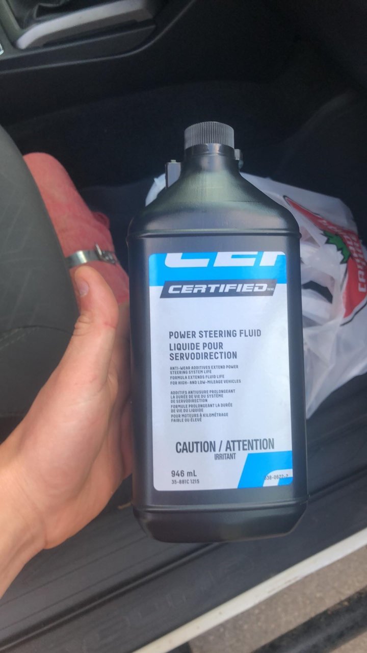

    I stop at the nearest automotive shop and grab few bottles of unnamed P/S fluid and complete another entire flush of the system. After taking for a long drive again I check the fluid and to my surprise it's almost all there, still a minor leak, I would figure the seal got fucked by ATF fluid, so now I'll add stop-a-leak additive and just SAS this poor taco after...
    TLDR. Don't use ATF fluid, get actual power steering fluid. Prove me wrong.

    This caused your problem:
    It's a low viscosity fluid more similar to Toyota WS than Dexron III. In fact, many use it to do A750 transmission flushes...
    The Toyota D3 I used lasted the remaining life of the truck (all of 3.5 years)

    https://www.napacanada.com/en/p/VAU...Transmission+Fluid&keywordInput=valvoline+atf
    says DEX III and "prevents leaks", guess they should've said causes leaks...

    I'm suspicious of a fluid advertised to be interchangeable with both Toyota WS and Toyota IV:
    https://sharena21.springcm.com/Publ...2d889bd3/3fa3136a-09bd-e711-9c12-ac162d889bd1
    My local Toyota dealer has Toyota-branded "D3" fluid on the shelf. Cheap, too, like $6 a bottle.

    Yeah... I've read both horror stories and praises with Maxlife ATF being used as ATF. I've used it in previous two slush boxes but as said above, it's an LV fluid and causes leaks for some. Its "compatible" but it is not a genuine Dexron. It smells horrible and pours like water. Hopefully no damage to pump running it dry and seals not swollen by additive package In it.
    I believe something like this would've been closer to stock fluid: https://www.napaonline.com/en/p/VAR...0VDGx1FF1Cw9UzBmu04yEyEiI__DCGFEaAmSNEALw_wcB
