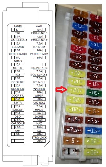

    Check the fuse for the Passenger's window. Check as in verify with DMM. Not just "visually".
