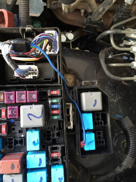

    saving these for future install reference

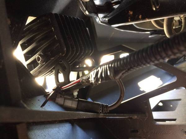

    Next I did the Anytime Fog Mod. This mod was super easy. There is a thread on here for it on the Cheap Free Mods page, but its for a 05-11. Its slightly different for 2012+ and there is a thread about it somewhere. This is what it looks like. I picked up some Rigid Dually's and used the stock wiring harness so I could use the stock fog light switch. It's extremely easy. Cut the plug from the Rigid harness with enough wire to work with. Cut the stock plug and peel back the housing for some room to work with. Splice the wires from the Rigid plug to the stock harness accordingly and you're done. I don't have detailed pictures of this, just the finished product, but you can get the idea.
    After you pull the OEM fog light switch out you will see 4 wires on the connector.
    White with a Black Stripe: Switch Ground
    Blue: Fog Light Trigger
    Green with a White Stripe: Dash Illumination Ground
    Green: Dash Illumination Positive
    [​IMG][​IMG]

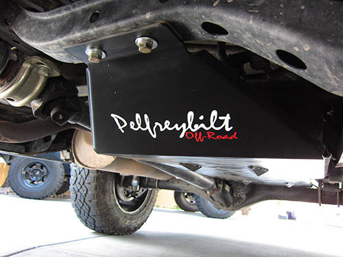

    added the Pelfreybilt gas tank skid a while back. Figured its time to show it off along with the article in TCT mag

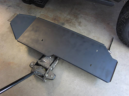

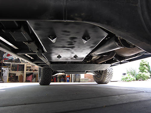

    Be sure to check out http://www.pelfreybilt.com/ for all your metal fab and off road supplies!!
