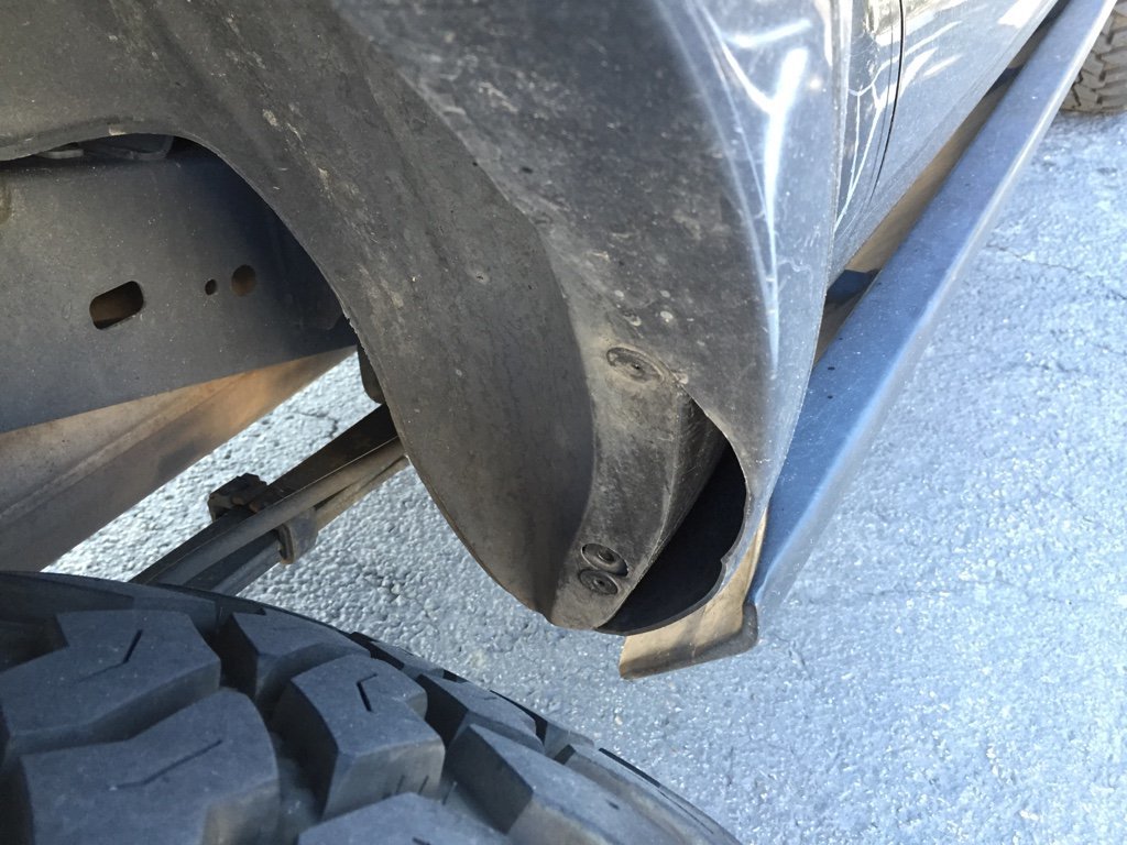

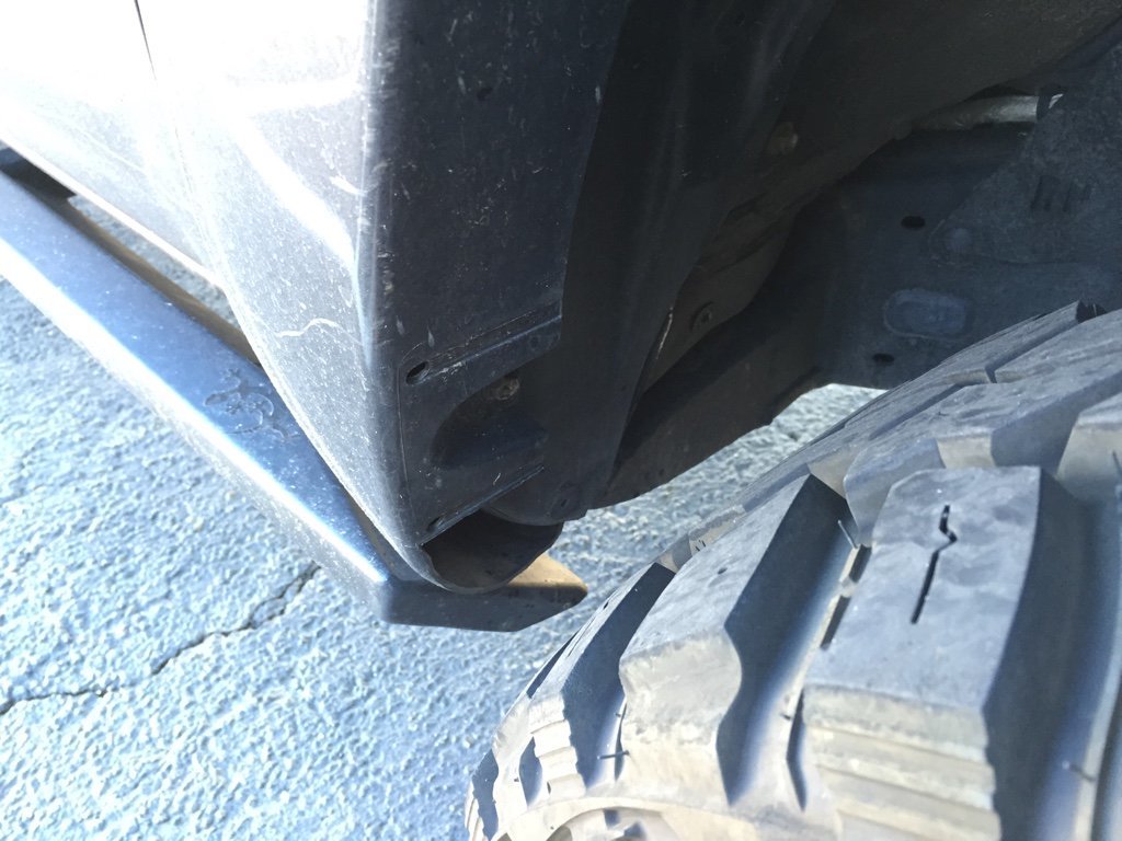

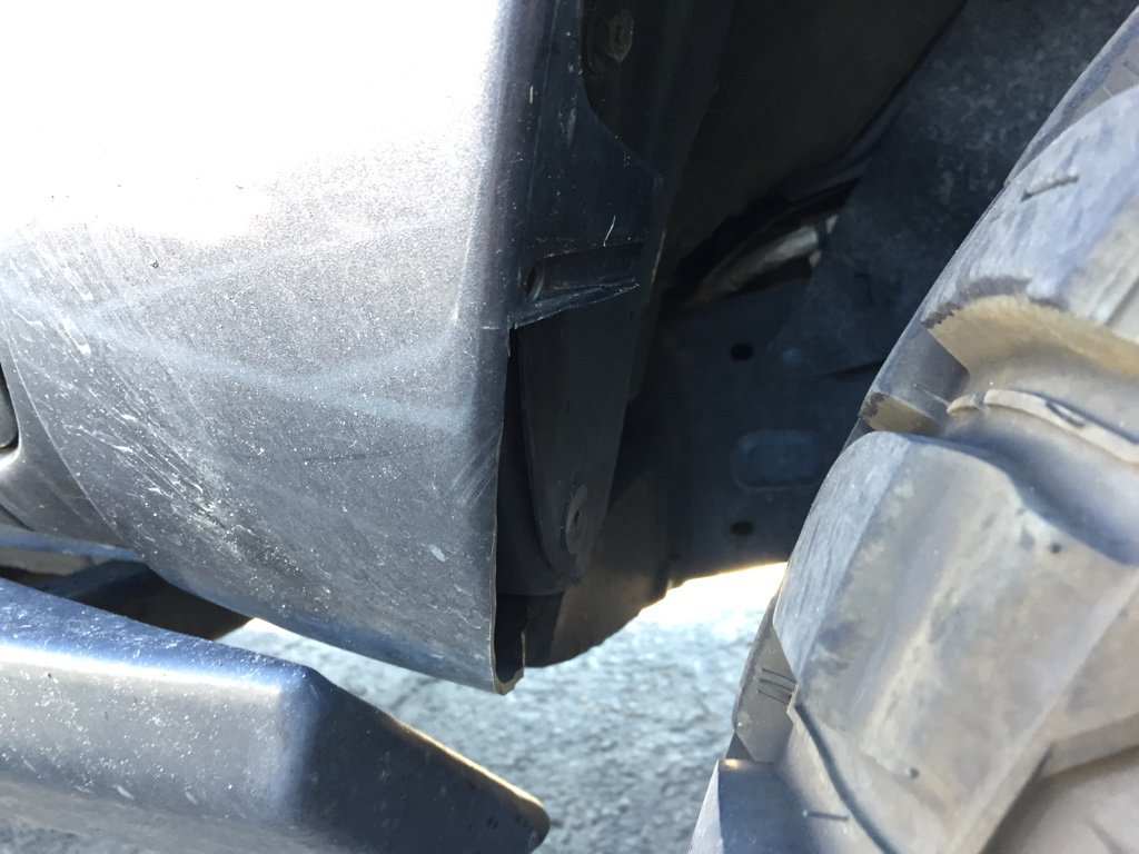

    Cab Mount Chop
    Trim inside plastic fender next to the cab mount chop (basically took all plastic off where the bend of the fender comes into the wheel well)
    Rear plastic fender inside trimmed (took bottom two bolts of fender out and trimmed all plastic inside on the lower fender in front of the wheel)
    Still have mud flaps in the rear
    NO mud flaps in the front
    if i really slam the front end down hard then i rub the under side of the fender on the top of the tire but i try not to do that very often, don't want to bend a spindle :D

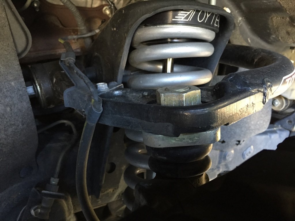

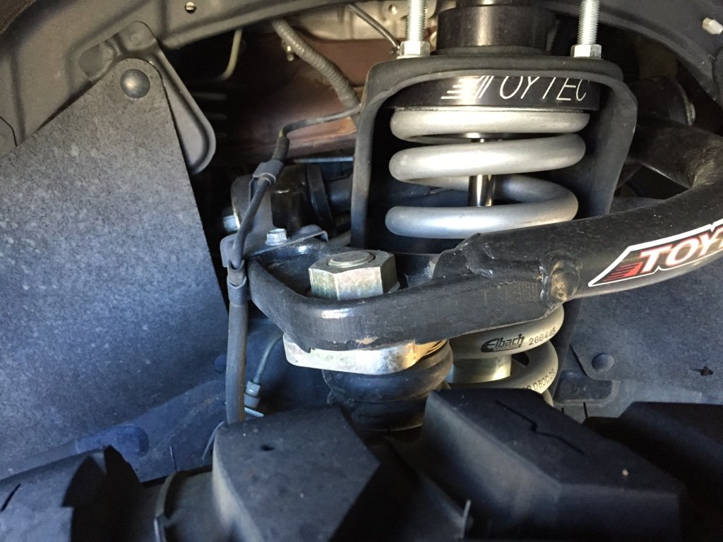

    @thefatkid would be able to tell you exactly what to let them know. I wanna say we just pushed the position of the UCA one notch forward, here is a photo of how mine sit right now
    We tried for two notches forward on the drivers side but it ended up making me rub at full lock on the CMC so we moved it back to this position and all is good
