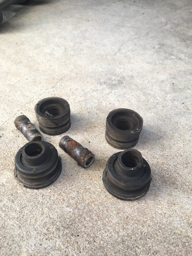

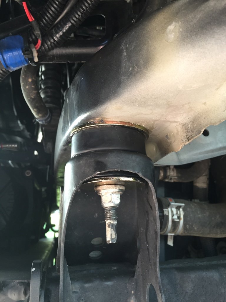

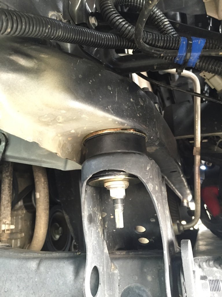

    What are these? How often should they be changed?

    look at the thread that i linked at the top of this page, or my images a page back. They are Radiator support bushings. Mine were dry rotting and falling apart so i spent the $23 bucks for piece of mind and replaced them, very easy job. I don't think its how often its when and if you need to replace them at all, its all opinion really. Im the only one that has replaced mine out here in CO that i know of. Take a look at the thread and look at yours to see if you want to replace them or just let the OEM bushings be, i haven't seen any ripping of the sheet metal like some of the images posted in that thread.
    https://www.tacomaworld.com/threads/polyurethane-cab-mounts.361346/

    took a read through the thread on the poly radiator bushings, walked outside and snapped a picture of mine and they were pretty dry rotted so i decided to replace them with the poly bushing ES kit. You use your OEM bolt and nut but toss the OEM bushings. It was just for piece of mind really.

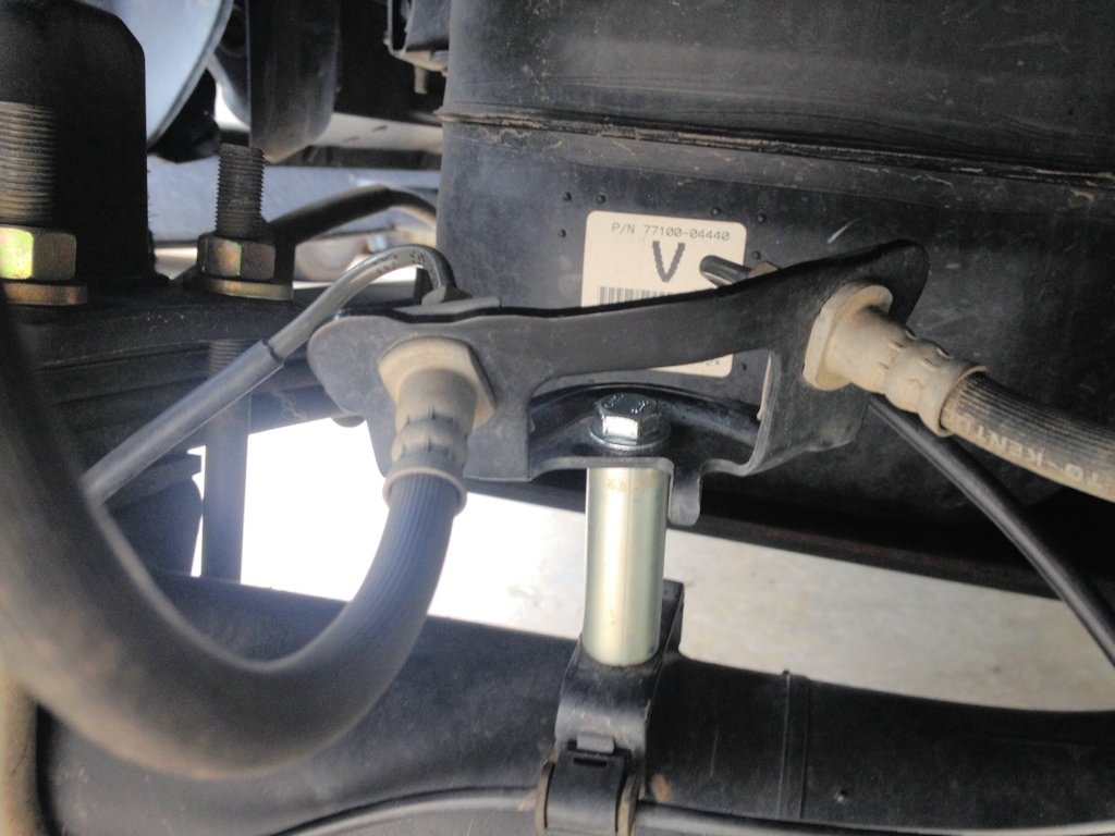

    what is the bottom pic of exactly? sorry just never seen that before.

    That's the "I'm too cheap and lazy to buy extended brake lines" mod
    I know all about it as I'm running the same mod :D

    Hahaha very creative! How's it done?!

    Just shim the mount up with washers or a long sleeve and a longer bolt.

    Then you get even more slack in the line when you did that mod first and eventually get longer rear brake lines.
