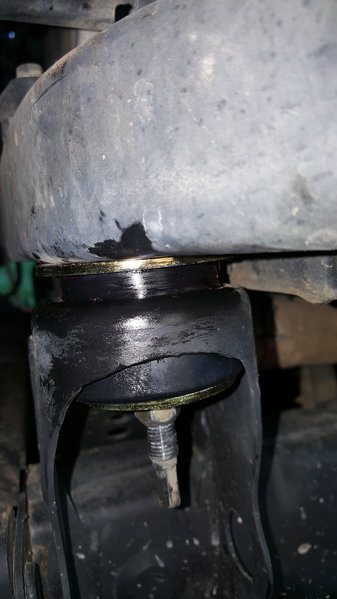

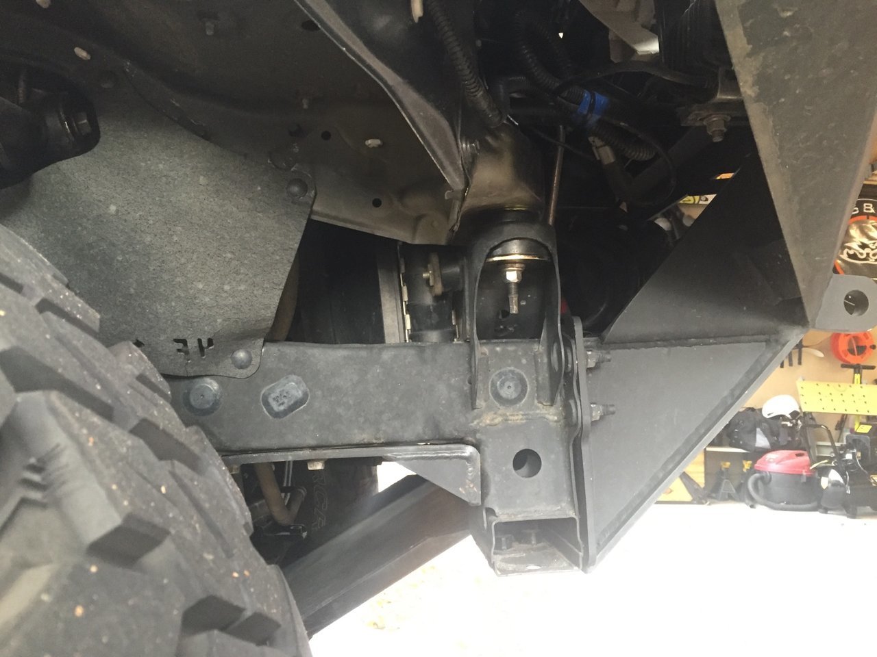

    I'm actually thinking of swapping mine to the way that Energy Suspension recommends installing, washer on both outsides, small bushing on top, big bushing on bottom.

    Just did mine today. Didn't see any destructions, did I do it right?
    PS78[QUOTED][OP] and SilverGhost like this.

    Yep, thanks for reminding me to put mine into that configuration
    Just flipped, had to put an image of some awesome tires :D
    And a close up of how they sit now, I've had these in 3 different configurations now but this is what's recommended by energy suspension.

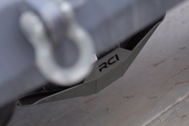

    picked up my RCI differential skid this past weekend, installing soon. waiting on my Baja Designs 20" light bar to fill the slot in the Pelfreybilt front bumper :D After that i foresee a RTT sometime in the next year or so

    How does that RCI diff skid look? Beefy?

    its awesome!!! i was looking into them at the toytec event this summer and its a great design, can't wait to bolt it up!! going to paint it OD green first to match all the other OD green elements on my truck.

    @Joshp767 (RCI Metalworks) Diff skid went on this weekend, great product at an amazing price. If you are in the market hit them up directly or contact @ToyTec Lifts to purchase.

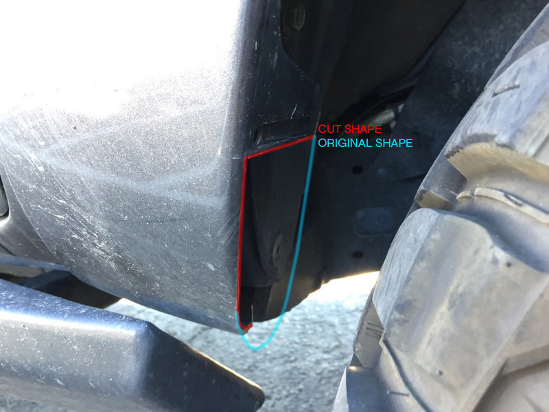

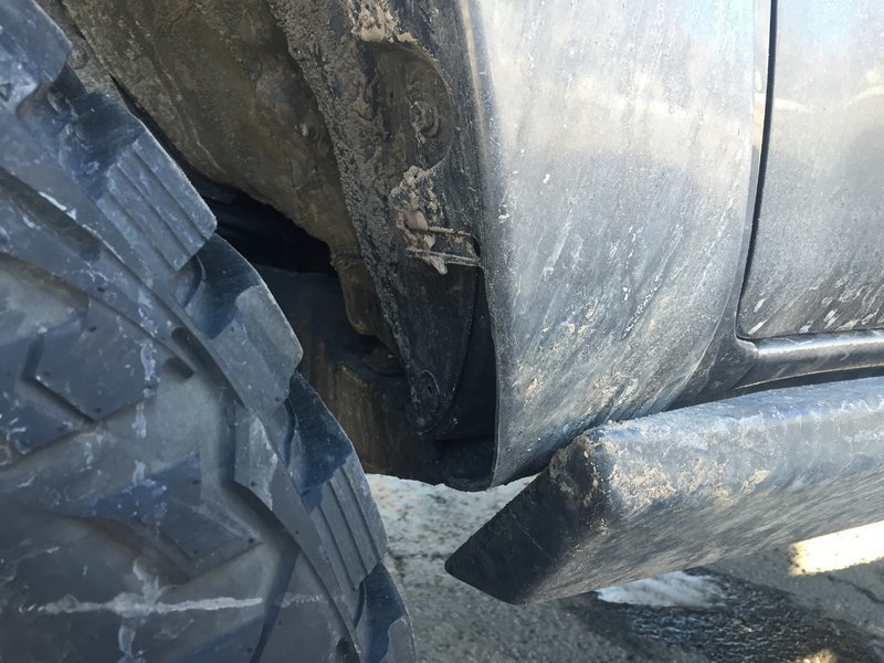

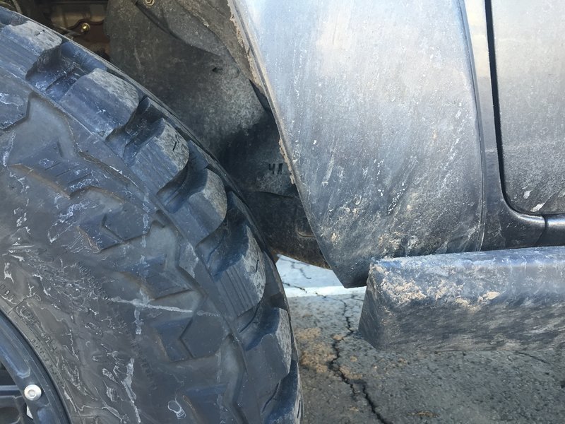

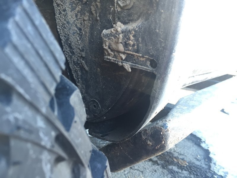

    its been a while since i posted about cutting my fenders on the lower front but here is some more images since people keep asking about it and rubbing problems
    here is a straight on image of my cut job, its tough to see because you really are only taking the bottom inward so it almost looks like the stock fender lines
    straight on from the side
    looking in to the fender liner, CMC is just visible behind tire on the left
    close up of the fender plastic trim, CMC isn't visible as its behind the tire
    blue is what the original shape kinda looked like, it comes forward towards the tire quite a bit, i was rubbing in the same spot as the OP, not anymore since cutting the red line
