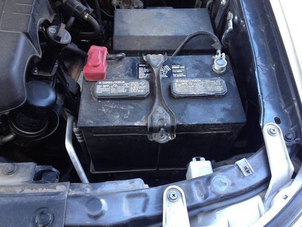

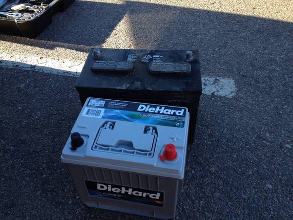

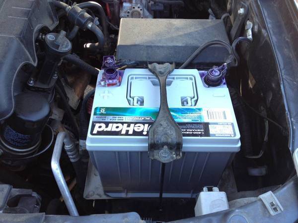

    Out with the OLD **POS*** OEM Group 27 with 710 CCA
    Comparison
    In with the NEW **AWESOMENESS** DieHard Platinum Group 35 with 850 CCA
    Martyinco likes this.

    it was a very easy decision, the POS OEM battery died!!! sucks too cause i brought it into the dealership just before 36K and now im at 37K and it decided to crap out :)
    I would have went with the beast that eric (gramps) has in his truck but i didnt want to buy a new battery cage and i dont have as much extra equipment to run like he does. Didnt warrant having that monster, even though i considered it.
    Bob: RUNS GREAT, starts right up! i was almost 90% sure it was the battery when it would try and crank over and then slowely crank on every try and then nothing. last night i really killed it running a voltage tester and current tester out of the cigarette adapter :)

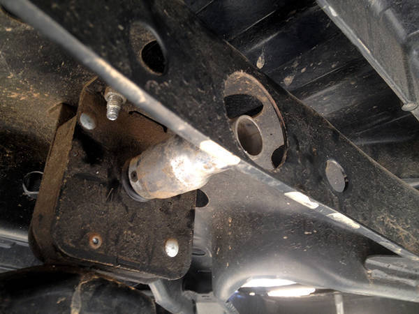

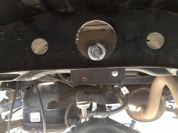

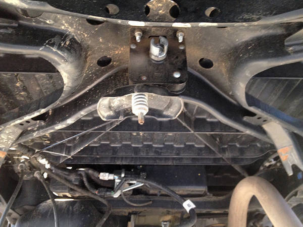

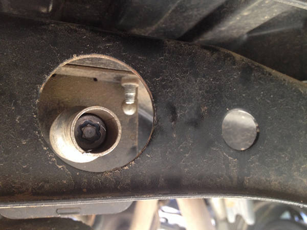

    I finally got sick of hearing the spare tire locking mechanism sleeve rattle around tonight so i climbed under the truck and took a dremel tool to that annoying rattle.
    BEFORE
    AFTER
    Dont know if anyone else has this rattle while wheeling but it annoys the piss out of me, even with the tire held up in place that metal sleeve holding on the monkey key rattles all over the place and sounds like a bell. I have my spare locked in the bed now anyways so if i could have i would have dropped the hole spare holder.

    Ratchet wrench either a 10 or a 12 to those bolts from the top and it will fall off. If you do take it off I will take it off your hands. :)

    I tried to remove those bolts and drop the whole carrier but the bolts want to go up towards the underside of the bed and won't budge!!
    You can try next time I'm over though :). And now it doesn't have the monkey key anyways, would you still want it?

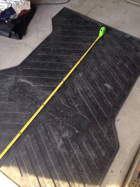

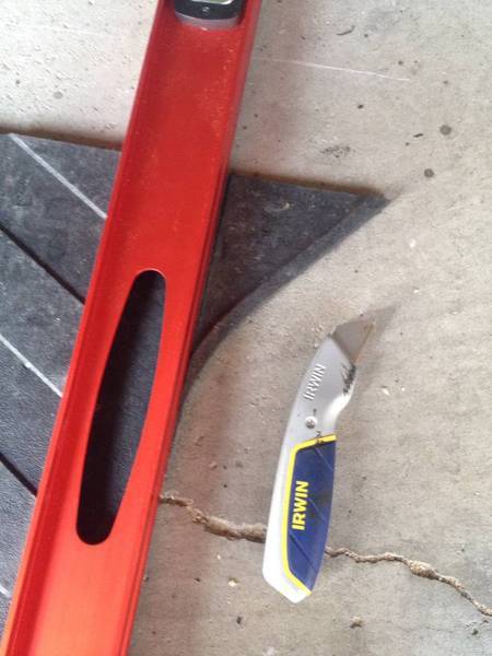

    to many to list, check the build thread

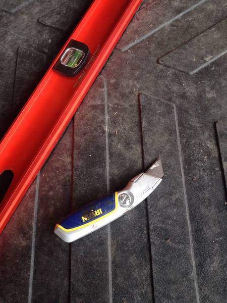

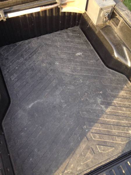

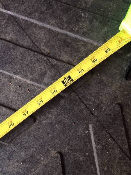

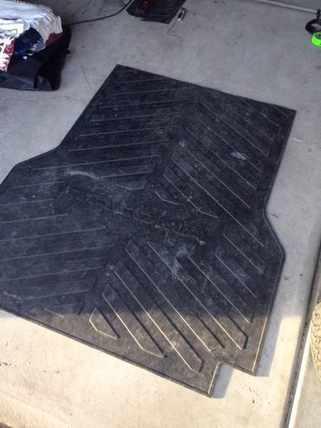

    Bought a Tacoma OEM bed mat tonight, ended up finding a long bed version so i thought i could just cut it down to fit the short bed. I was right, very easy to do with a straight edge and a utility knife. Couldnt pass up $45 bucks for a OEM Tacoma Bed Mat
    Measured the bed, 5 foot from end to end
    made my cut mark at 5 foot all the way across with the straight edge
    then cut, only took 3 to 4 passes with the utility knife to get through the thick rubber material
    Finished up by cutting the tabs straight where the wheel well finishes on the long beds.
    Finished product, no more sliding around crap in the back bed! :woot:

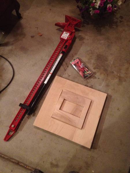

    Hi Lift base finished, cut out of 3/4 inch plywood and doubled up so that the 10x10 base fits inside the 20x20 inch slot. This will be used in loose dirt or sand for a more stable jack point. Im going to paint them black and seal them with poly along with attaching some leftover bed mat material to the bottom of the 20x20 base.
