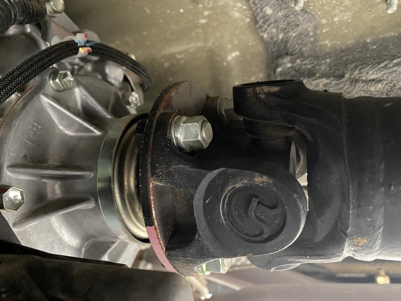

    I'm sure you more knowledgeable folk have already realized this, but 2019+ tacos still have zerk fittings on the front prop shaft. There was a thread a while back where somebody had incorrectly mentioned that 2019s no longer have any zerk fittings on the drive shafts due to being sealed joints. Sometime later a reply (that I missed) mentioned that the front prop shaft still does and unless you go to an amazing mechanic or dealership, the likelihood of them greasing them is relatively low. Will not greasing it make or break your truck? Not really,b ut they spin a lot so you can extrapolate how dirty grease and rapidly spinning parts fare. Why the harder to reach front is not sealed and not the easy to reach rear joints are only the toyota engineers will know.
    If you decide to grease the front prop shaft zerks, I highly HIGHLY recommend something similar to https://i.ebayimg.com/images/g/KUcAAOSwW9RhRtxb/s-l500.jpg where you are able to simply lock on to the zerk fitting.
    EDIT: Just found this megathread https://www.tacomaworld.com/threads/check-your-u-joints.409042/page-79.
    In summary, most guys are saying that 2020+'s have done away with the zerk fittings. But still check, maybe you're a unicorn and have them.

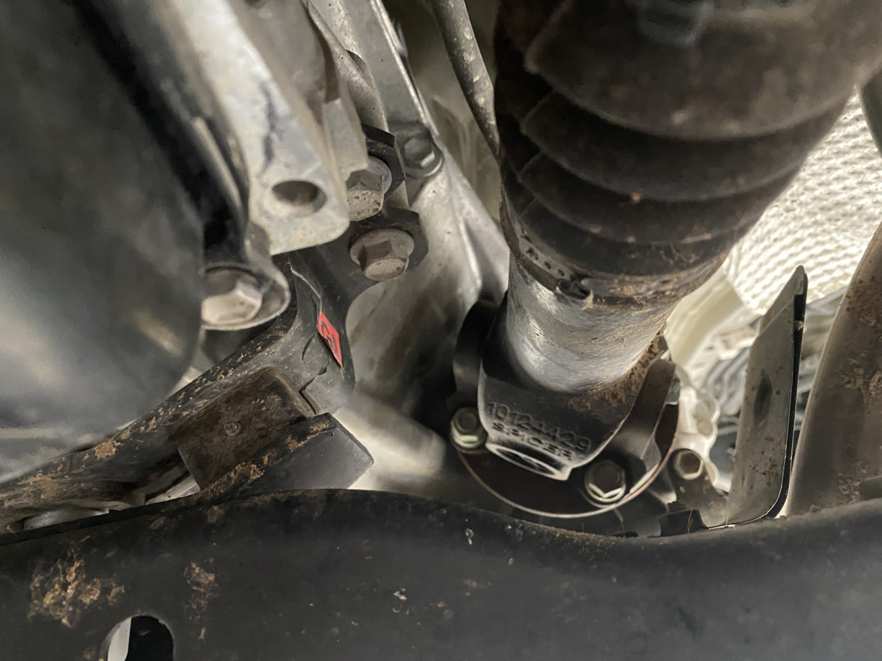

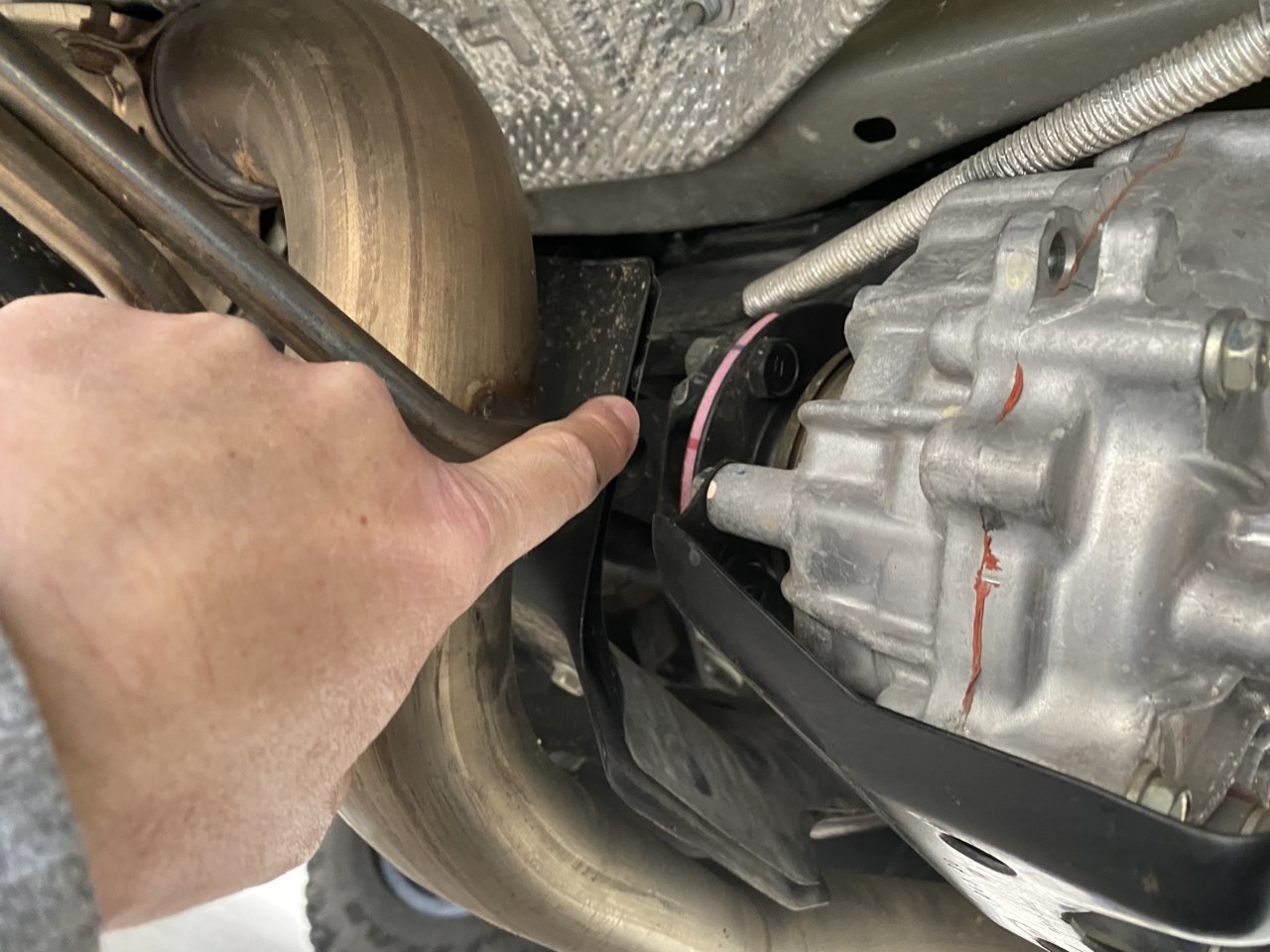

    I have looked and looked and must be friggn blind. ZERO zerks on my 20 OR. I'd pay someone local to show me...but they pay me when they don't find them.

    You have to remove the little skid plate where the front drive shaft meets up to the diff to see one of them

    Front grease zerks are inside the u-joints. You have to remove the skid plates and spin the propshaft around until you can access them.

    Im must be blind still guys. Changing diff fluid later today and will take the little skid off to look closer.

    Crawl under there with a flashlight in hand. Maybe a ratchet and socket to remove the small skid plate. Feel around, look. Turn the shaft to see all 4 gaps at each joint.
