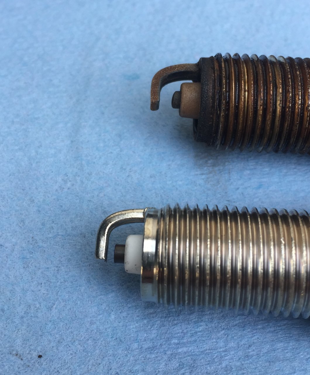

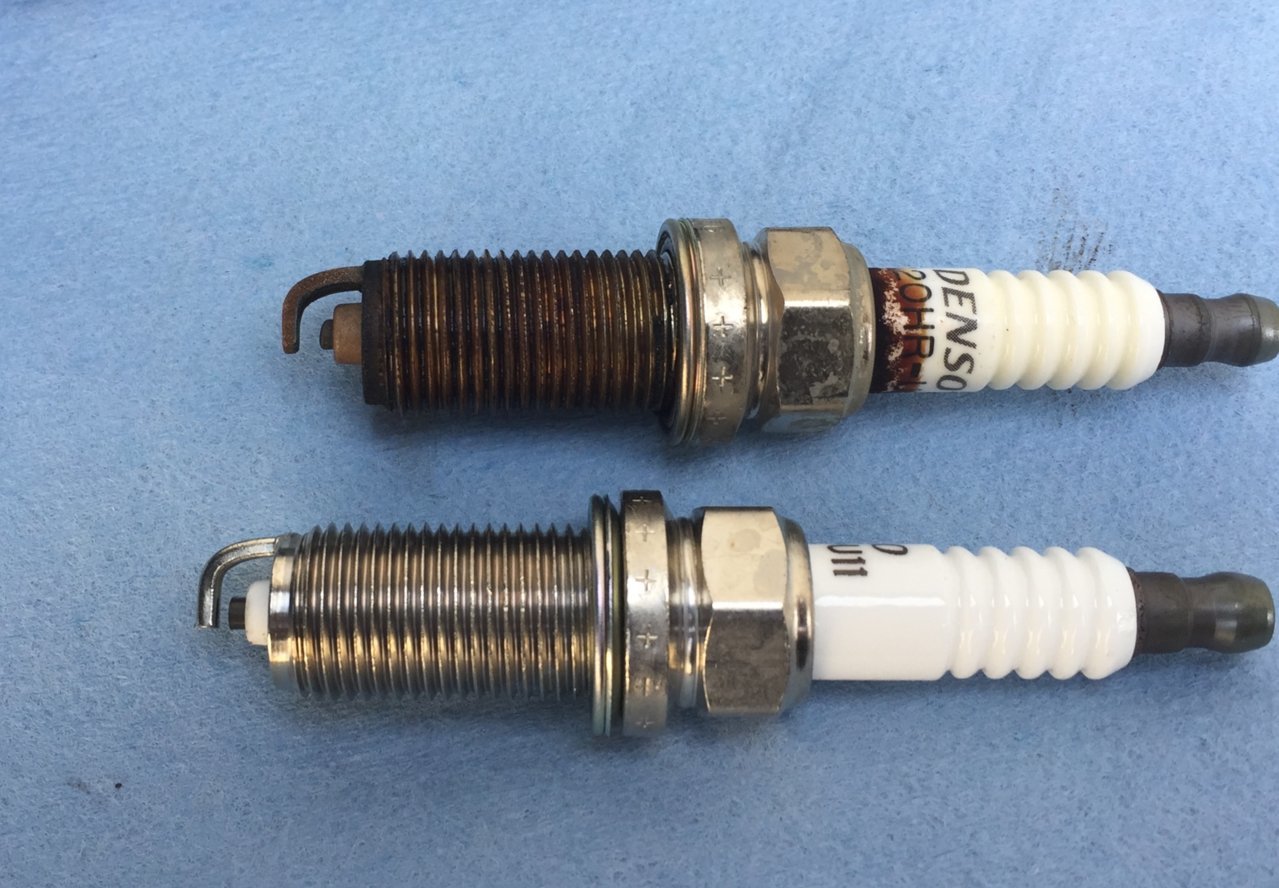

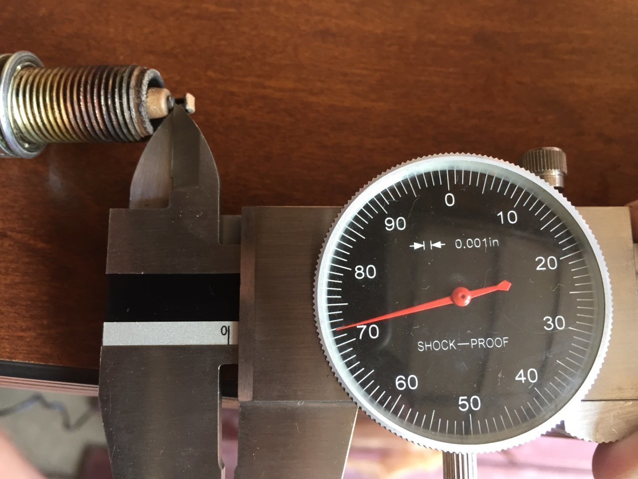

    I had some spare time today, so I replaced my spark plugs with OEM Densos all around (2nd Gen V6 at 111k miles). I was told the dealership replaced them before I bought the truck, but these look pretty bad. Factory spec for the gap is .039-.042 ......these were averaging .071 :eek: My guess is that these were the originals, and the stealership didn’t change crap!
    And before I get flamed for using calipers instead of a spark plug gap tool, the calipers is all I have at the moment of writing this; and yes, I used a spark plug gap tool to pre-gap the new plugs as soon as they showed up in the mail.

    the factory copper spark plugs are recommend to be replaced every 30k miles because the copper wears faster but perform better. If you want to know if they were factory or not look at the spark plugs. From the factory one cylinder head was installed with denso plugs and the opposite cylinder head was installed with ngk, i believe because they were produced in different plants but either way that is the true tell if they are original or not.

    This is the other reason I’m guessing they were original, and why I said I replaced them with Densos “all around.” The passenger cylinders were Densos and the driver cylinders were NGKs. I doubt the dealership would pay attention to that minor detail, but I could be wrong.
    I did check for that. The plugs were a nice “paper bag” tan, but the cores were really worn down. I’ve changed copper plugs at 50k miles before that weren’t THAT worn down. Also, my VTX is carbureted, so I pay very close attention to the color of my plugs because they tell me if I’m running too lean or too rich.
