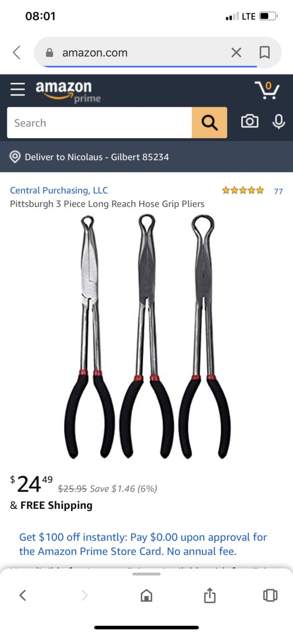

    Do u have a set of those needle nose hose clamp pliers? Those work well on connectors too

    Like vice grips? If so, I do not. I have only one large pair of those nut fuckers. :D I can see those working, but I like the flexible nature of forceps. I have four different sizes and shapes of those.
    They're invaluable when working on the bike.

    Like these. Work good for pushing on the tab that releases the connector.
