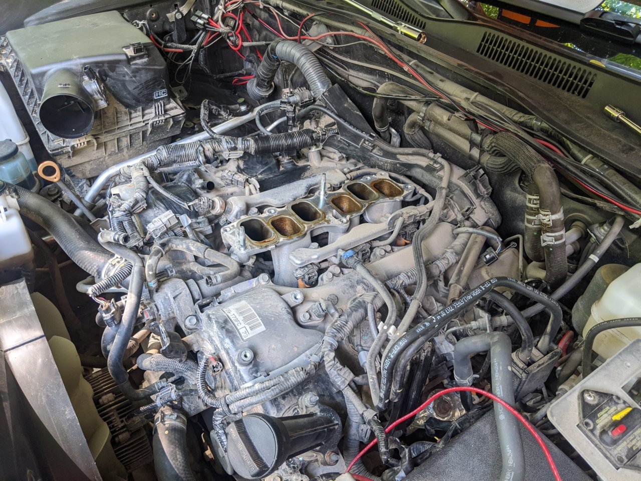

    It's not so bad. 70k. I don't know how you got the last drivers side plug closest to the fire wall. I couldn't get to that bracket that held the little heat pad off.

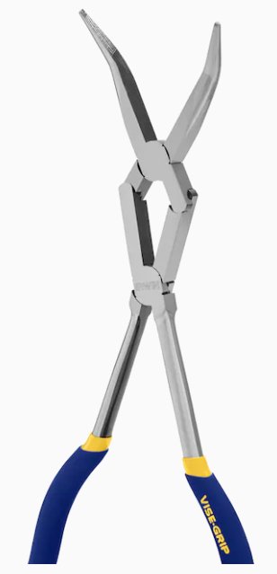

    Nice! I do not. I have been trying to find a need for these, but nothing yet:

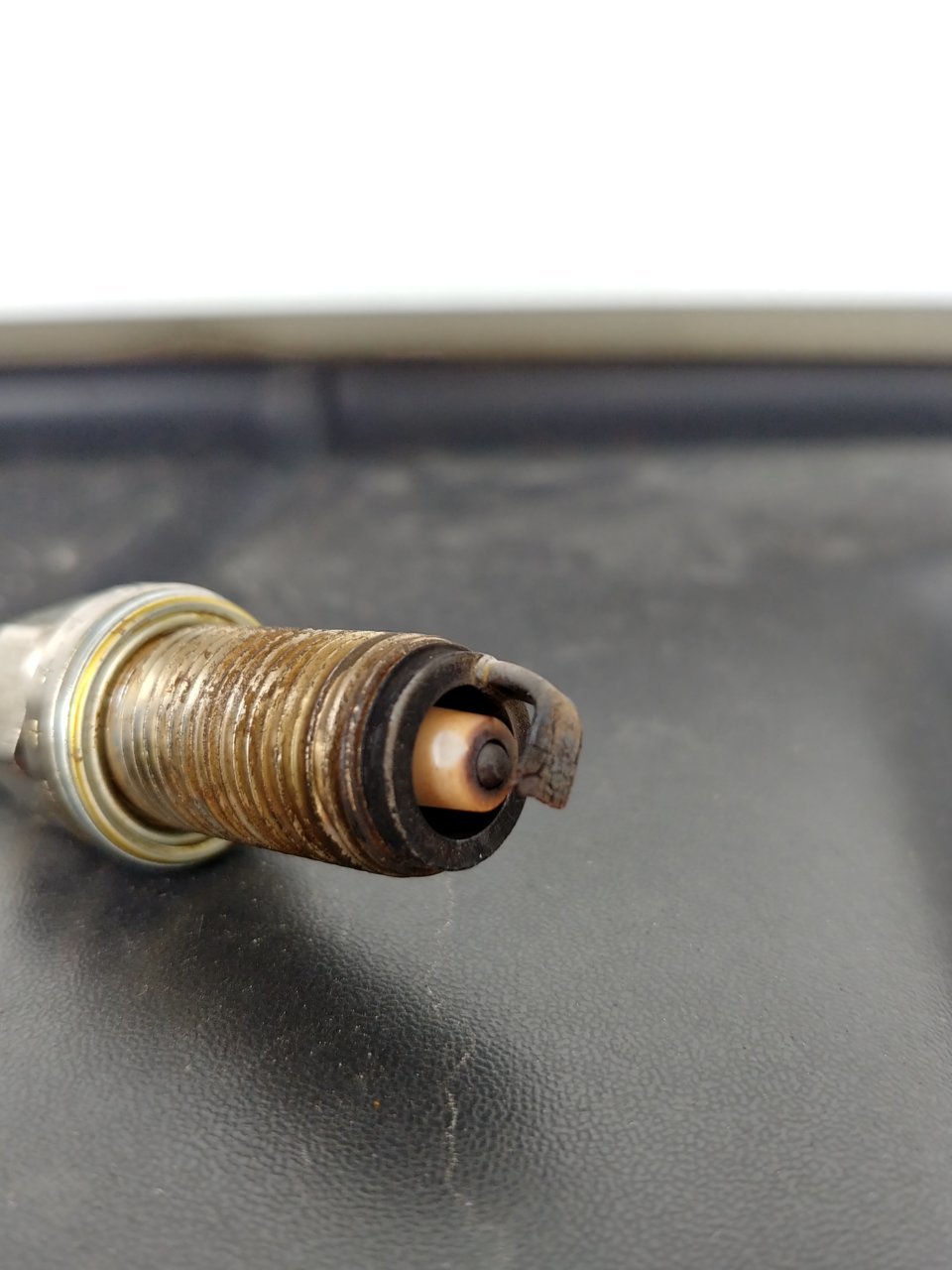

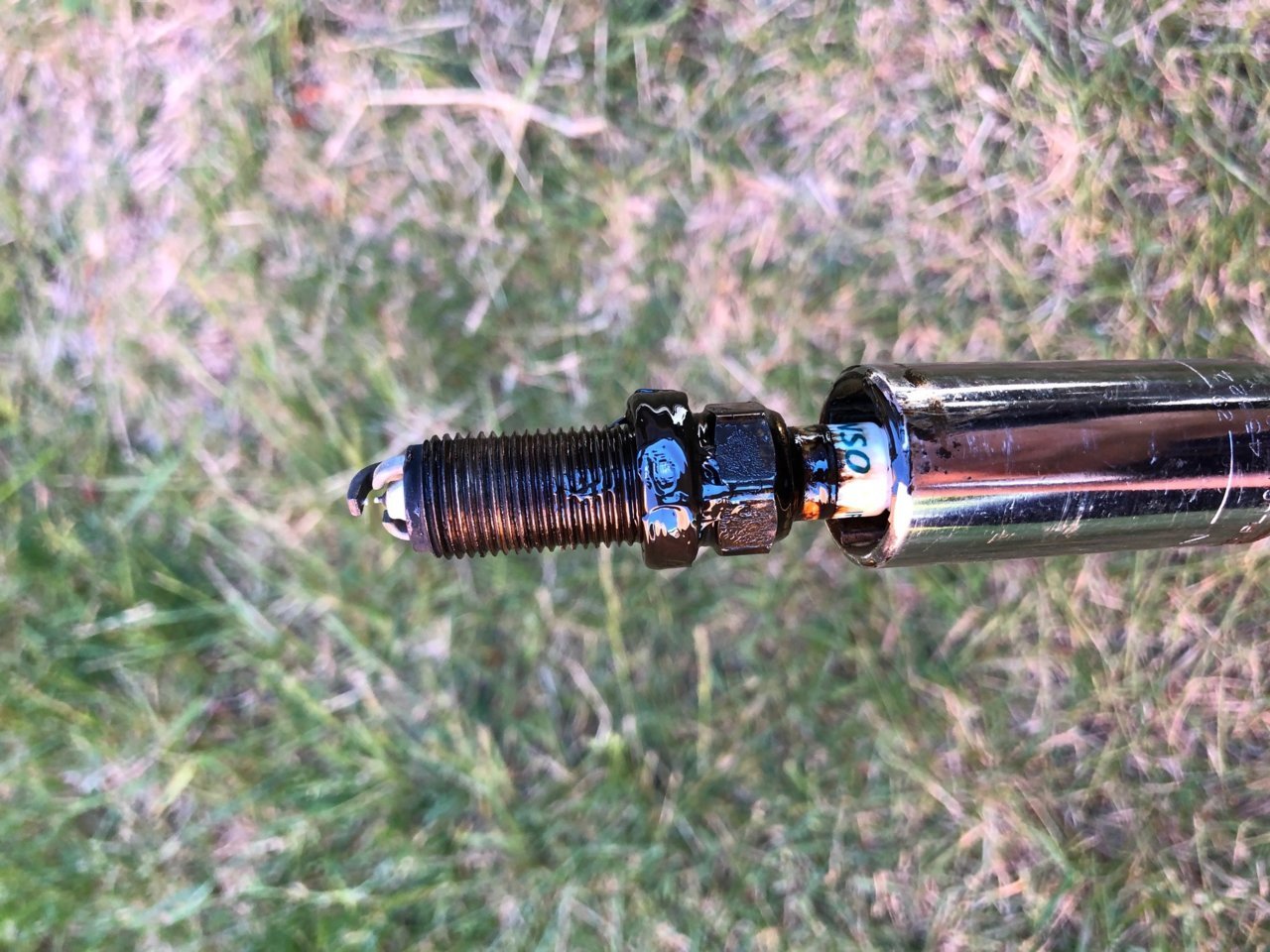

    Here is another PSA
    I almost destroyed the engine in our Rav4 because I bought counterfeit Denso plugs off ebay without realizing it. Here are the pics I posted on the Tundra forum. Look at the electrode.

    That pad was held on by that one nut? Once the nut was off, the foam wiggled out. But yeah, that was the worst one.
    I was surprised how there was just enough room to get the packs out on the left side and get a socket and extensions down the hole without using a wobble.

    Whoa.
    You know, as cheap as plugs are, it's best to spend the extra $4 you would save by going online and buying from your local supply chain or mom and pops auto parts store. They'll get you the real stuff every time.

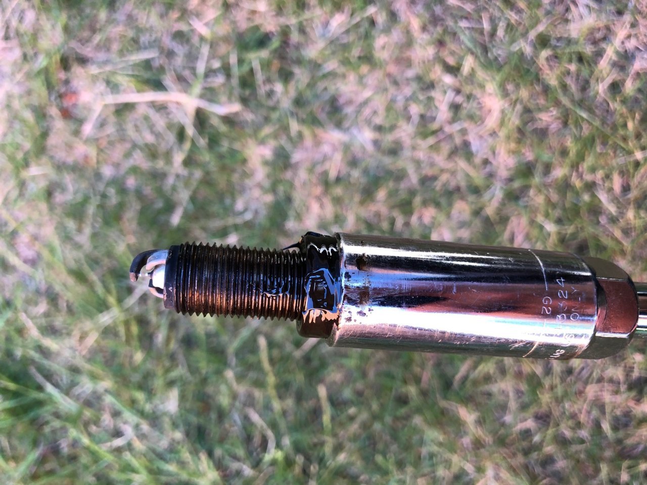

    I just looked these up and how they separate, that’s craziness, who would devise such a convoluted design

    Surprised there wasn't a compression leak and throw a code.
    So does there seem to be any pattern to this? Year, model, build date, factory?

    It’s pretty easy, in fact I’ve had more problems with drivers/most front plug than the back one. The back one I removed top bolt from the bracket and loosened the bottom one, this allowed me to get it out of the way. Once that was done, I removed insulation pad, it was held by 10mm bolt, it came out no problems. Once that was done, removing coil/plug was easy.

    Surprised too. I mean if my logic is correct, there would be little to no compression in that cylinder. Truck seemed to have been running ok, no codes ever, misfires or rough idle. Glad I caught it though.
