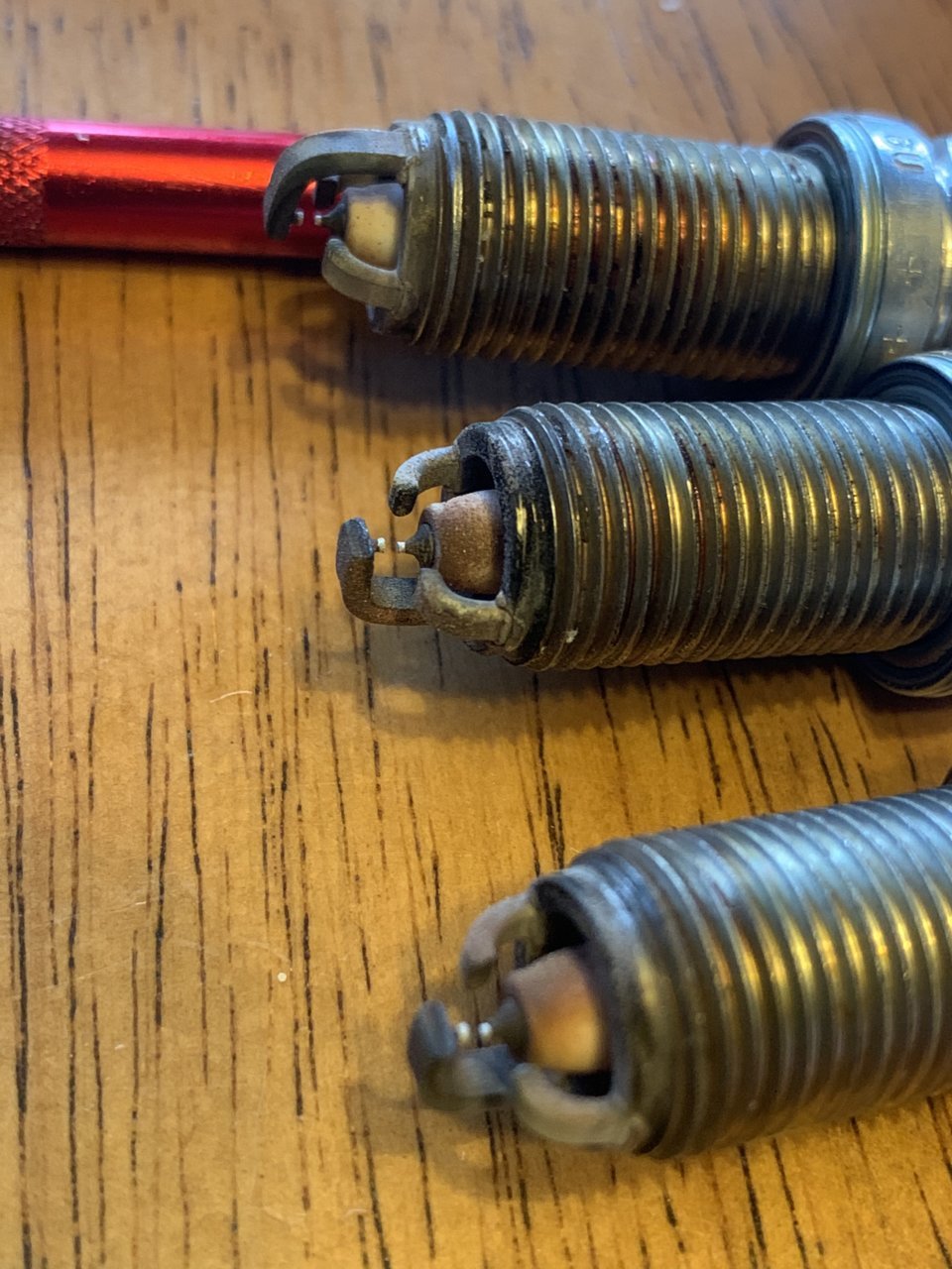

  14. Jun 27, 2020 at 8:03 PM
    #134
    Skydvrr
    Skydvrr IG: @kalopsianick
    Sep 13, 2017
    #229889
    12,654
    Nick
    YMH
    Black '17 OR
    Passenger plugs were in great shape, no drama here, no loose plugs, although threads were dry and chattered on the way out. Had an extra 20 mins after dinner so I knocked the passengers side out. Driver's side tomorrow along with a pad slap and maybe play with transmission fluid.
    AKGSD, Shellshock and Hank Heel[OP] like this.
  15. Jun 27, 2020 at 8:16 PM
    #135
    Hank Heel
    Hank Heel [OP] Well-Known Member
    Sep 18, 2016
    #197637
    1,644
    WA
    Those look really good, how many miles again?

  17. Jun 27, 2020 at 9:23 PM
    #137
    Hank Heel
    Sep 18, 2016
    #197637
    1,644
    WA
    That’s super clean. Do you have a catch can? Because I don’t see oil particulates that would typically be on the threads of spark plugs
